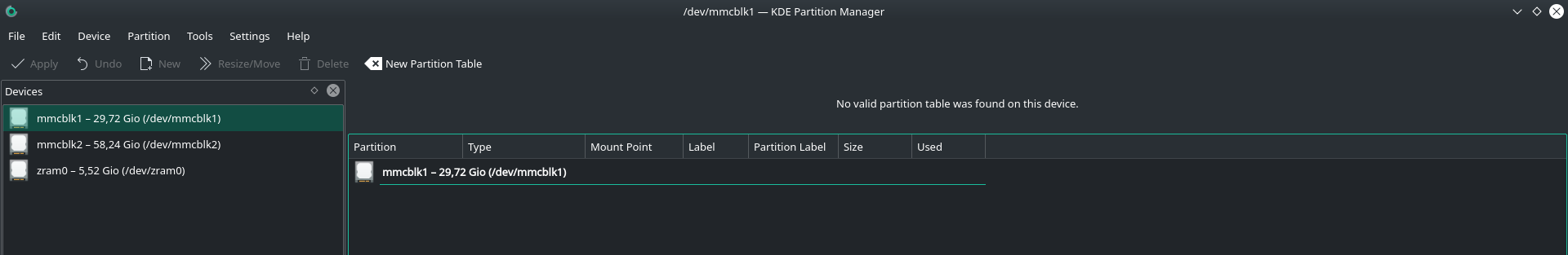

(06-19-2020, 02:12 PM)tophneal Wrote: What's in KDE's partiton manager?
here's what i've got.
.png   partition.png (Size: 41.92 KB / Downloads: 870)
#32
(06-19-2020, 02:35 PM)slow_motion Wrote: here's what i've got.
hmm, there should be an unrecognized/unmountable partition seen on the SD.
#33
so etcher might be the problem here?
