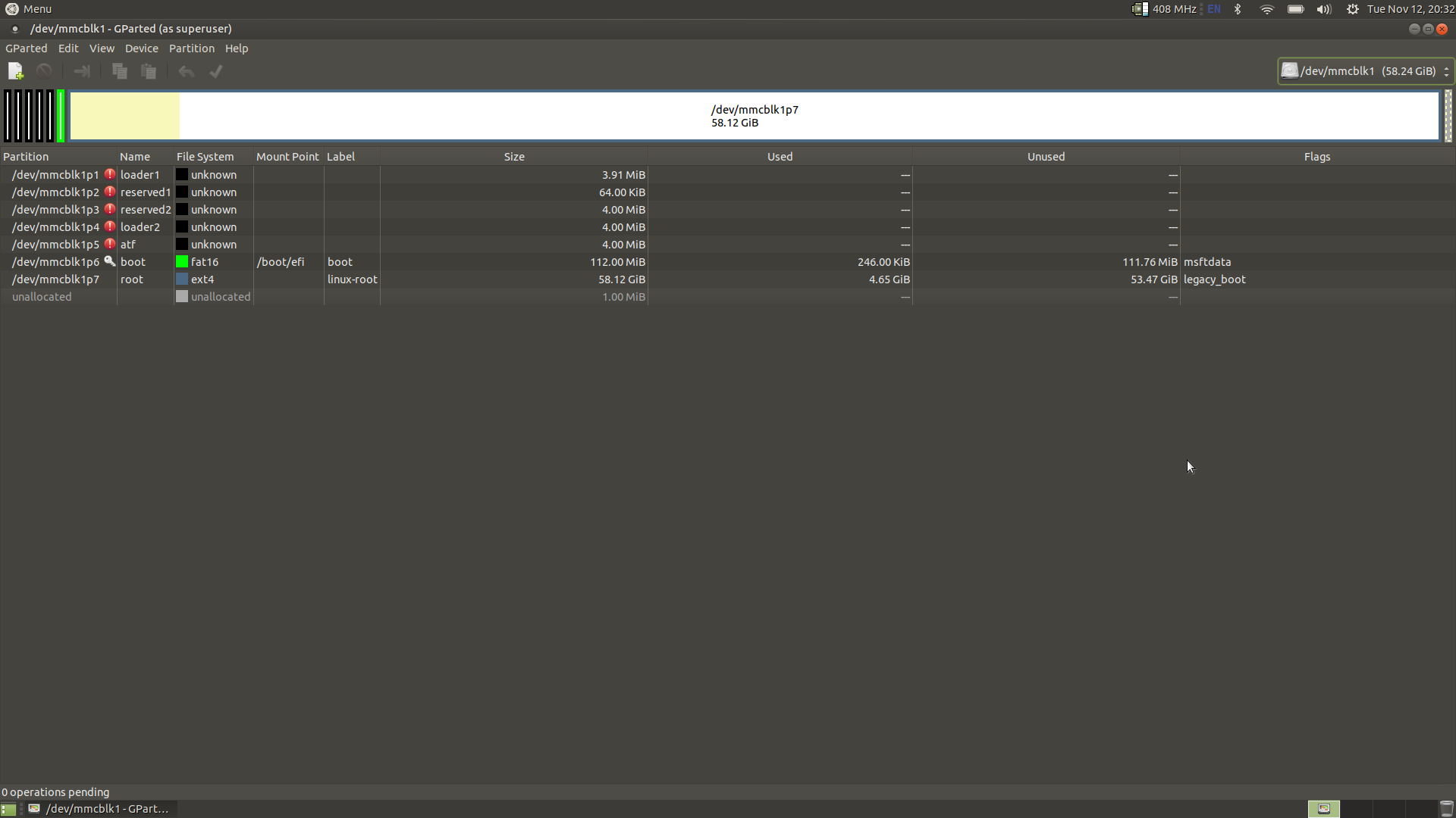

Hey guys,
I can`t get Ubuntu to boot from the eMMC. I flashed according to the tutorial, then launched gparted, which told me to increase the gpt on the eMMC to match the actual size or something similar, so I did. Then the boot partition on the eMMC was FAT32, so I wrote the SD-card boot partition over to the eMMC with
sudo dd if=/dev/mmcblk0p6 of=/dev/mmcblk1p6
I also extended the ext4-partition to consume all of the remaining free space. Now gparted looks like this on the eMMC
.png   eMMC.png (Size: 95.77 KB / Downloads: 915)
but it does not boot from eMMC with the SD-card removed. The power LED lights up orange and nothing happens. It will boot from SD when it`s inserted after a few seconds of orange LED.
What am I doing wrong?
Bjoern
#38
I deleted the boot partition on the eMMC and copied the boot partition from SD to eMMC with gparted instead of dd, and now it boots from eMMC! Should have read the first post more carefully...
Best regards!
