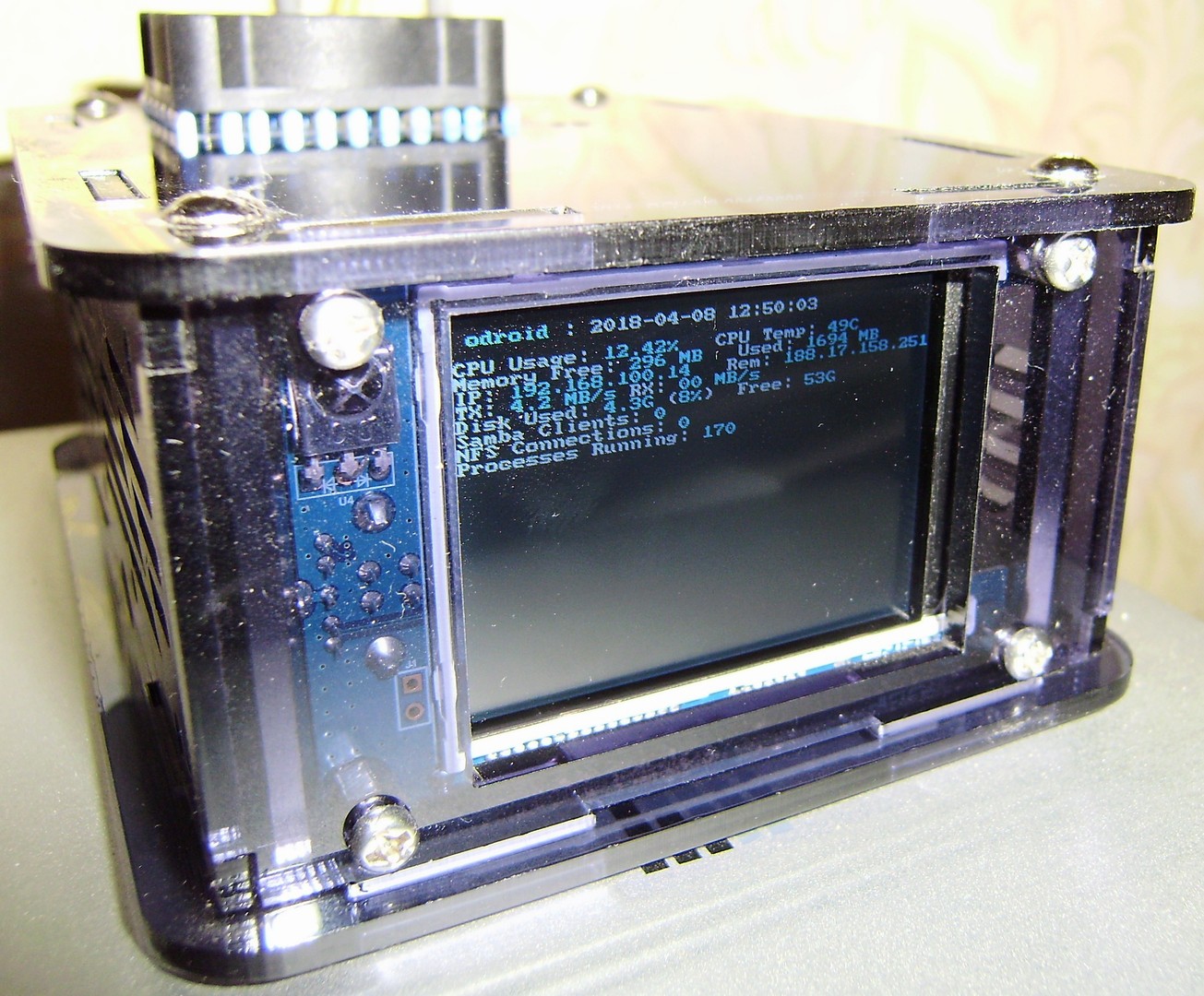

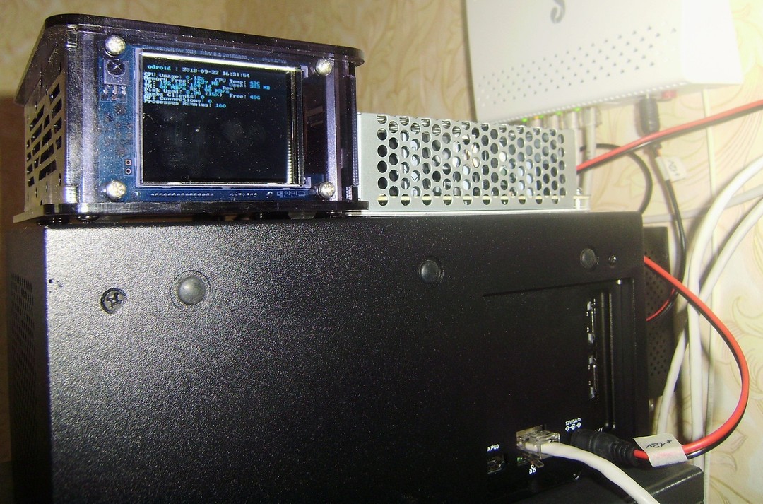

This case lacks a display, for status indication,
The ODROID-XU4 has such a display - very convenient !
I would like us to have a similar display.

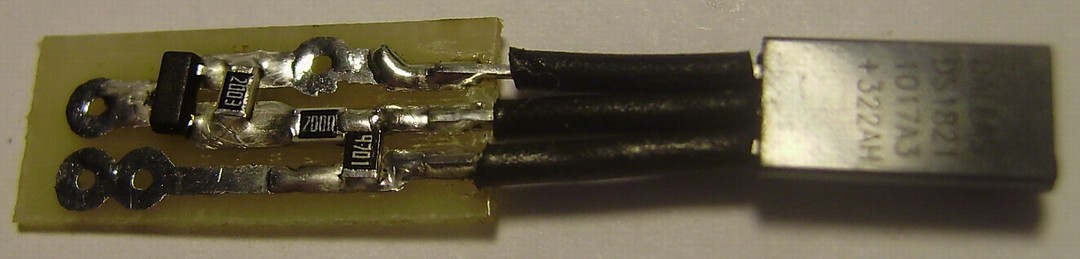

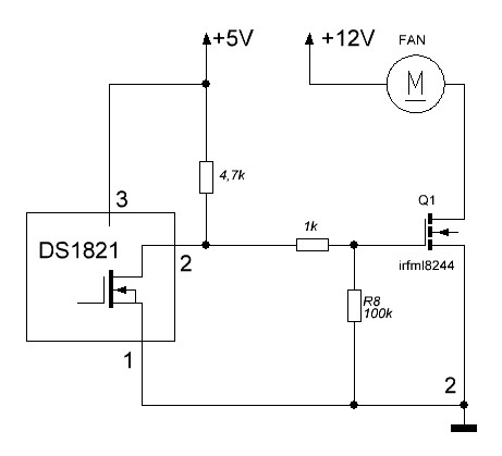

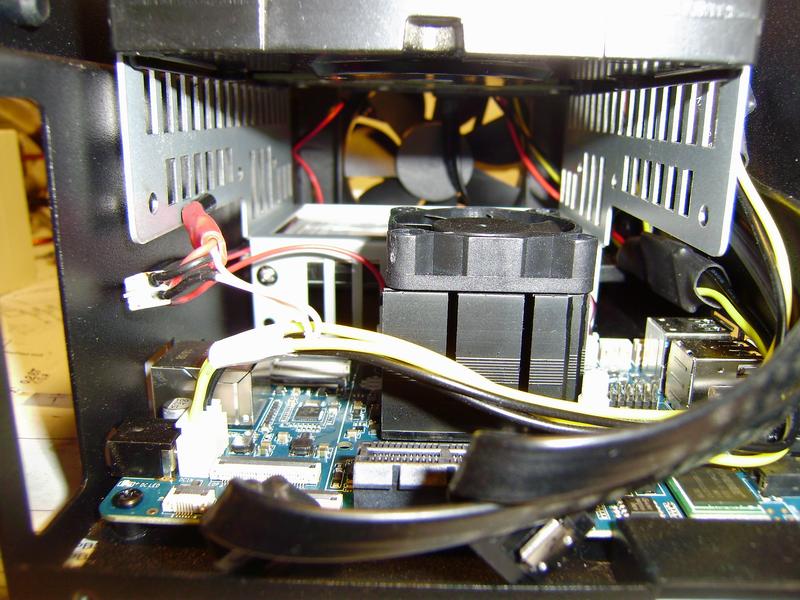

I am satisfied, the only thing I was missing - a thermostat for the chassis fan,
a regular fan connector is used for the MCU fan on the heatsink,
but I made it myself on the basis of DS1821, programmed in thermostat mode,  shutdown <= +32C, switching-on of >= +37C
Ground and +12v took from the SATA power adapter, from the wires near the connector to the board,
+5v took from the connector Pi2, the thermostat itself is glued to the chassis.
The temperature regime of the MCU is +36C... +43С, at an environment +25С.
