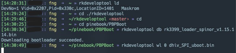

I'm having a hard time getting through actually flashing the SPI (see attached). I waited roughly 20 minutes for the process to complete, but nothing is happening. I've tried to redo the entire process a few times and am still getting the same result.
The logfile outputs:
15:01:23 Error: failed to stat config.ini, err=2
Any ideas?
.png   Screen Shot 2020-02-07 at 2.36.55 PM.png (Size: 104.58 KB / Downloads: 804)
(02-07-2020, 05:08 PM)pinebro Wrote: I'm having a hard time getting through actually flashing the SPI (see attached). I waited roughly 20 minutes for the process to complete, but nothing is happening. I've tried to redo the entire process a few times and am still getting the same result.
Any ideas?
Not sure. maybe you are missing a dependency?
here is a full like to the wiki: http://opensource.rock-chips.com/wiki_Rkdeveloptool
if you have some issue though, its probably best not to continue. its a pain to recover SPI and this project is in very early, minimally tested stages.
#19
Thanks for the wiki link. Just tried from another computer and same issue. All dependencies are installed and up to date, but I'm going to take your advice and hold out for a while. For now, I'm still pretty happy just being able to have my home folder on nvme.
#20
(02-07-2020, 04:23 PM)Wizzard Wrote: I erased that flash using the command supplied in the first post. I had not connected any of boot devices except NVMe and eMMC in PBP. Should I disconnect them too?
I tried boot also from USB using SD to USB adapter, but the result was the same. Blank screen with backlight.
As I said before - probably you have not erased the flash completely.
Try this:
fallocate -l 16M zerospi dd if=/dev/zero of=zerospi bs=1M count=16
Then flash this file to SPI using rkdeveloptool:
rkdeveloptool db rk3399_loader_spinor_v1.15.114.bin rkdeveloptool wl 0 zerospi rkdeveloptool td rkdeveloptool rd
That should definitely get rid of any leftovers in SPI. Then reboot pbp and write @"dhivael"  uboot again.
