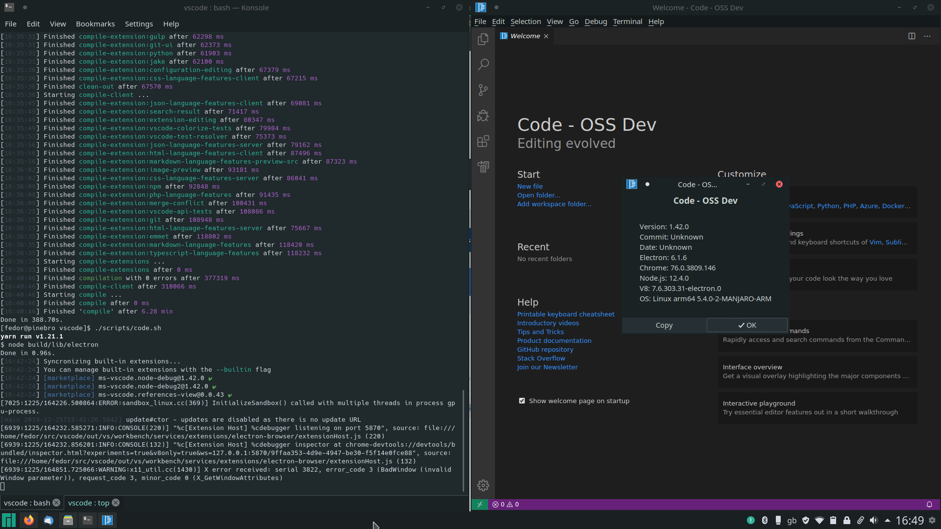

To me getting VSCode aka Code-OSS to run was quite important. So in case anyone else cares about it too: it builds from sources on Manjaro ARM.
You need to install base-devel and python2.
Then get the sources from https://github.com/microsoft/vscode and use yarn to build it.
Note that to use the Marketplace for Add-Ons you need to patch your product.json as described in https://github.com/microsoft/vscode/issues/23831
Simply add
"extensionsGallery": { "serviceUrl": "[url=https://marketplace.visualstudio.com/_apis/public/gallery]https://marketplace.visualstudio.com/_apis/public/gallery[/url]", "cacheUrl": "[url=https://vscode.blob.core.windows.net/gallery/index]https://vscode.blob.core.windows.net/gallery/index[/url]", "itemUrl": "[url=https://marketplace.visualstudio.com/items]https://marketplace.visualstudio.com/items[/url]" }
Finally run it using ./scripts/code.sh
Here is what I looks like
.png   Screenshot_20191225_164915.png (Size: 370.85 KB / Downloads: 895)
