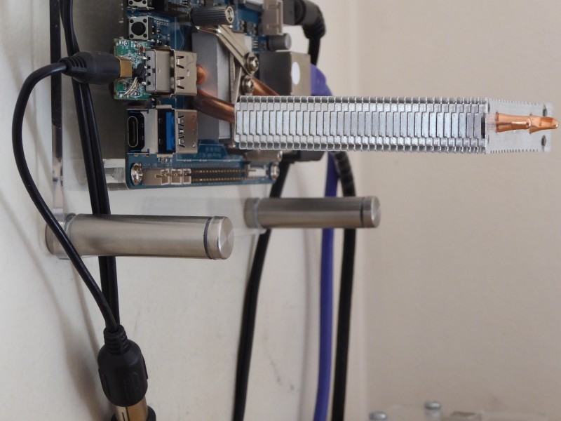

(09-29-2018, 09:01 AM)dukla2000 Wrote: Got myself a larger heatsink which works well. Stock Pine64 30mm job weighs 62g, this thing weighs 110g so should be useful. Running cpuminer as a benchmark indicates it is: stock 30mm at 2GHz was reaching 80C after about 15 minutes and throttling, this new sink seems to be able to keep under 80C (ambient 23C) indefinitely and running RockPro at 2.1/1.5GHz.
Had to mount it on the long axis of the board to prevent interference with the PCIe card. Available all over Fleabay - I happened to get mine from this vendor with no problems.

Access to the GPIO etc is no problem as hopefully the pic shows.
In terms of supporting the weight: this is subjective but I think NOT well is probably correct! I have no pets or children and so can leave mine hanging with no fear of too many accidents. Also I have mine mounted so the heatsink is hanging from the board (about worst mechanical case - the board is mounted vertically on a wall, but thermally nice for airflow!) rather than just standing on the CPU.
What would be nice is to have some kind of brace to out under the board. Impossible for the heatsink manufacturer to supply as they cannot know the actual bolt spacing that it gets mounted at - would need something non-conductive and RP64 specific as there are a lot of components on the bottom of the board under/around the CPU.
