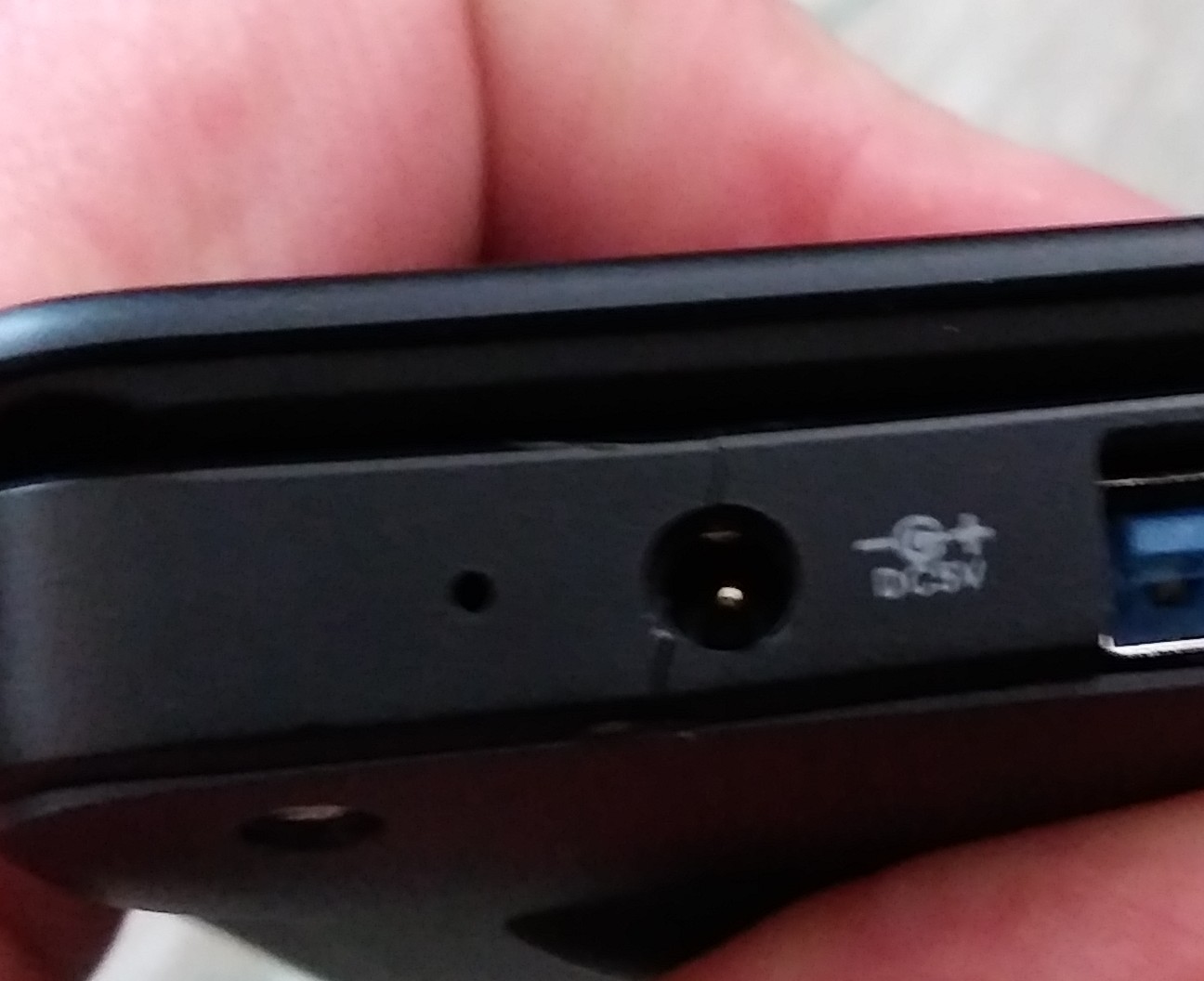

My Pinebook Pro currently has six cracks. The first ones to appear were the ones around the usb ports and power port. Then came the cracks on the body of the PBP when I forgot to put the spacers back in. Unfortunately, things got a lot worse a few days ago. I shifted my grip on my PBP to one hand on the left side for 10 seconds, and suddenly a new crack appeared on the top left of the keyboard. Now even with super glue the whole left side next to the display hinge bends every time I open and close my Pinebook Pro! I am scared even to close it again! Suggestions, anybody?! Except for this whole crack thing I have really been loving my PBP, but it might be time to say goodbye...

I don't think me forgetting to put the spacers back is the problem. The two cracks that my PBP got because I didn't put the spacers back in patched right up with super glue, and I have had zero issues with those two since (Loctite, to be precise). The two cracks that are the biggest problem are the ones around the power port and on the top left plastic casing around the keyboard. The two work together for a double whammy, if you will. When I open my PBP, everything is fine, because the stress is on the crack in the plastic I superglued. When I close it, however, the stress is on the crack in the bottom of the metal band, beneath the power port. Because I haven't put any glue there as I thought it was just a tiny insignificant crack, the whole top left corner by the screen hinge bends up because there is nothing holding it back from doing so. I am afraid that soon the whole corner will snap off! As best I can remember, the crack by the power port seemed to appear relatively soon after I got my PBP, seemingly because of stress when the power adapter was inserted. The crack in the plastic happened when I briefly handled my Pinebook Pro with one hand the other day.

Would I do that through the order support tab on the Pine64 main page? Also, is it possible to replace the metal band that goes between the top plastic layer and the bottom plate? As I mentioned, the crack underneath the power port is putting a lot of stress on the spot that broke on the plastic every time I close the laptop, and I am not sure that replacing just the top plastic part is a good long-term solution, as it would probably crack again with that stress on it in the near future. Thanks!
Images of cracks attached:
.jpg   20200415_112744_2.jpg (Size: 143.24 KB / Downloads: 1,031)
.jpg   20200415_112852.jpg (Size: 299.78 KB / Downloads: 951)

Yes, use the support tab on the main page. I'm afraid I cannot say for sure if that piece is replaceable, but I would imagine it should be. I would take these photos and include them when you contact support. Pointing to this thread for more details may be helpful, too.
