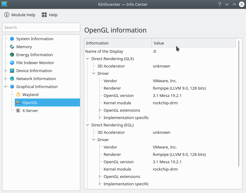

.png   Screenshot_20200120_203754.png (Size: 58.59 KB / Downloads: 845)
.png   Screenshot_20200120_204036.png (Size: 76.28 KB / Downloads: 972)

Yesterday I made another test with Armbian Ubuntu, installed KDE Neon on Bionic and it also runs well, including acceleration and sound. Sleep does work too, but does not wake up. Battery status does not work.
I found out that the following previous error is caused by changing bionic to eoan of focal in sources list. When I change that, this error appears after running apt update.

Seems that KDE Neon does not have kernel module working.
.png   Screenshot_20200121_184801.png (Size: 57.73 KB / Downloads: 878)
