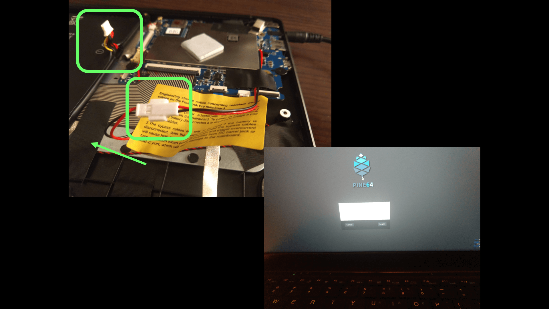

Added an attached image of the power bus cables for you
I found that the battery pack is evidently defective for my PBP.
Note my post from yesterday: UPDATE - NOW POWERED UP VIA MAINS! Re: PBP No Power
So, I effectively removed the bottom cover tested many avenues that have been recommended as you did.
I then disconnected the battery pack bus from the main board and removed the battery pack from the chassis, then took the red and black bus that is under
the yellow sticker and its female end that is  hidden under a piece of black anti-static shielding tape on the laptop chassis.
They connect and will allow direct power to flow from your AC adapter to the main board.
TO DO THIS THE BATTERY MUST BE DISCONNECTED AND REMOVED FIRST!
Once you make the red and black direct power connection, then try long pressing the power button on your keyboard.
Hope this helps!
I am still trying to obtain feedback on how to obtain a similar spec replacement battery.
But in the interim I was able to boot with direct AC adapter power and back to working with my PBP.
.png   Mains.png (Size: 326.35 KB / Downloads: 404)

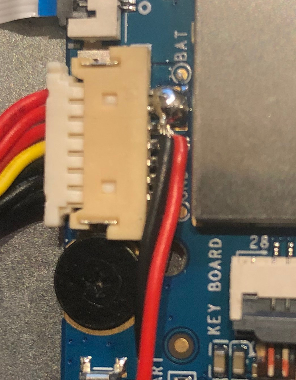

I measured on the battery. 4.16V DC between the red and black wires.
Nothing between the yellow and the black. What is the yellow wire?
Also, it does not boot when I connect the bypass cables.

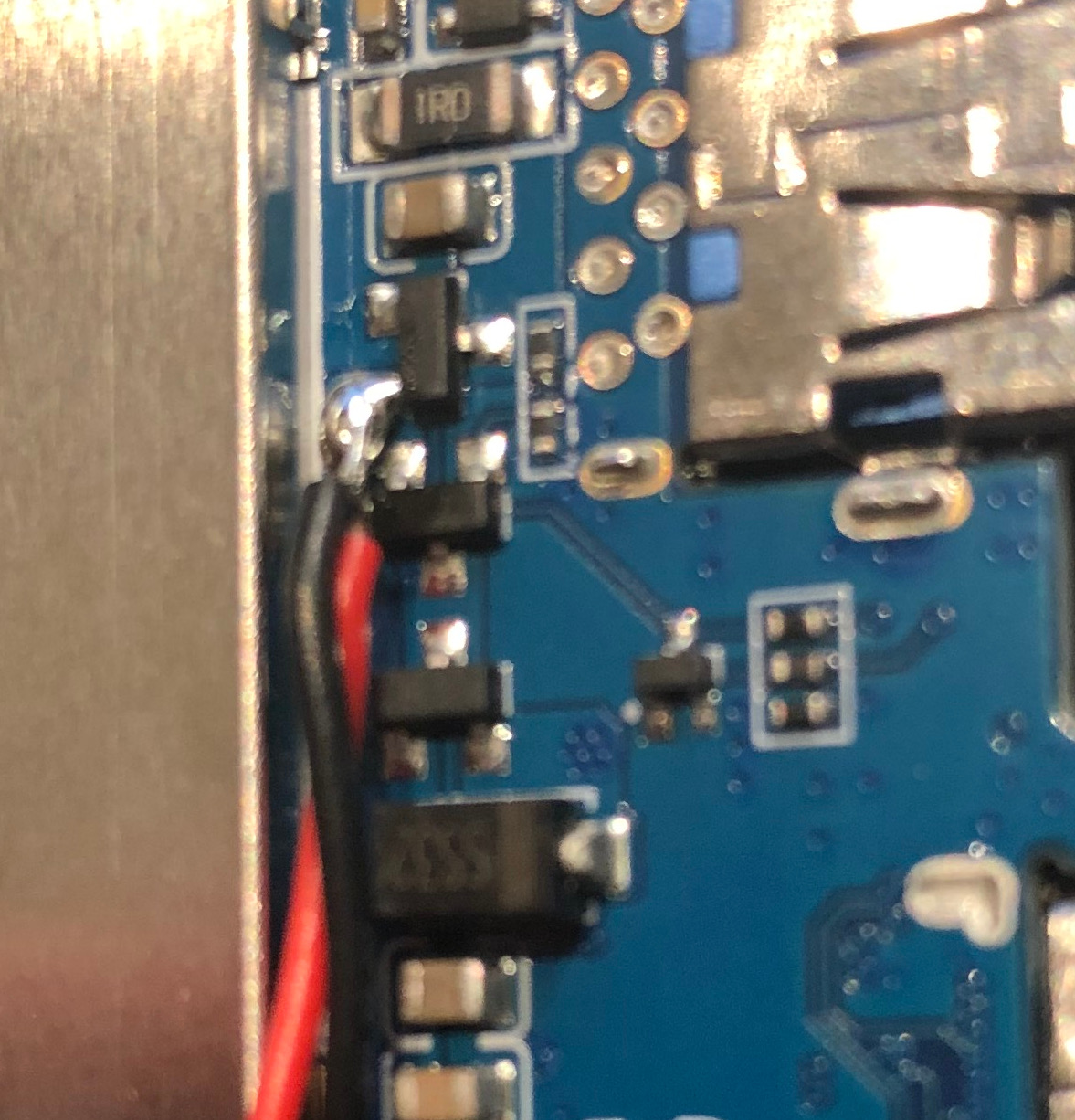

Why is the bypass cable two wires (red and white) when they are soldered together on the main print.
.jpg   IMG_0091c.jpg (Size: 361.21 KB / Downloads: 391)
.jpg   IMG_0092c.jpg (Size: 340.3 KB / Downloads: 349)
Is that correct? Can someone confirm.
When the bypass cable is connected I cannot measure any voltage on the DC In test point (against e.g power in socket).
With bypass cable disconnected, the charging led blinks.
Any suggestions?
