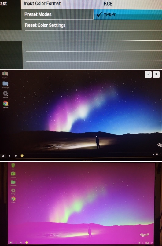

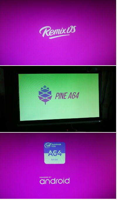

This is my case-
I did try installing 3 operation systems, Android, Ubuntu and Remix OS, and got the same result of the colour, which looks different from what I saw on YouTube (e.g. https://www.youtube.com/watch?v=7Dxl9jeLyEw)... I got a purple background rather than a black one... a green background rather than a white one...
Sad
(06-04-2016, 09:11 PM)tankie64 Wrote: This is my case-
Sad
Sad
Have you tried another hdmi cable?
Yes, I did. It seems it becomes normal when I change the monitor input colour format from RGB to YPbPr... Any idea what the reason behind...?  Huh
EDIT: HDMI-DVI cable was used for connecting the board to the DVI port of the monitor and direct HDMI to the TV is OK.
Not sure specifically why, but it is a common issue that is easily fixed.
