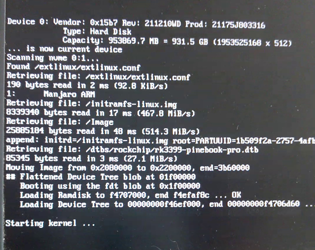

I was able to capture the last text on the screen from a Tow-Boot boot of my NVMe. Should I try a chroot into the NVMe and kernel re-install?
Cal
I don't use Tow-Boot (yet) but my U-Boot always says something just like "WARNING: Bad CRC. Using default environment." when it reads the SPI ROM (because mine is uninitialized). I don't know which device yours is referencing, but it's just saying that there's no U-Boot or Tow-Boot there, so its going to continue booting.
As far as the rest, hopefully someone else can comment; I'm not that familiar with Manjaru (or Linux actually, I use NetBSD). It sounds like you're deep in Manjaru territory (blank screen with no cursor is very common).

I still haven't found a solution to my NVMe drive not booting. I tried chroot and re-installed linux-image, which created the Image and initram files on the boot partition that I need, but I still can't get it to boot. There's a another thing that's really weird. My new Manjaro installation on my eMMC has an extlinux.conf file with a root UUID that doesn't even match the UUID on the root partition. I don't know how it can even boot. When I changed the UUID in the extlinux.conf file to match the partition, it failed to boot.
