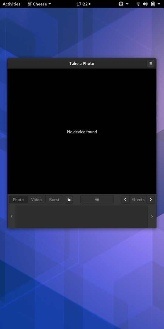

OK, I understand about the non-free driver, but please have a look at this Screenshot:
.png   Gnome hires sm.png (Size: 366.18 KB / Downloads: 882)
In your image installation (sorry, CoreShot does not seem to work there), the Cheese window is cut off on the right-hand side saying "Take a Phot". Also, the keyboard is missing all the keys on the right-hand side, including Backspace, which can make typing a bit awkward.
If this is not due to the driver, how can we tell Gnome to reduce everything by 50% to get an appearance like the above?
I can send you more hires screenshots to demonstrate what it should look like.
