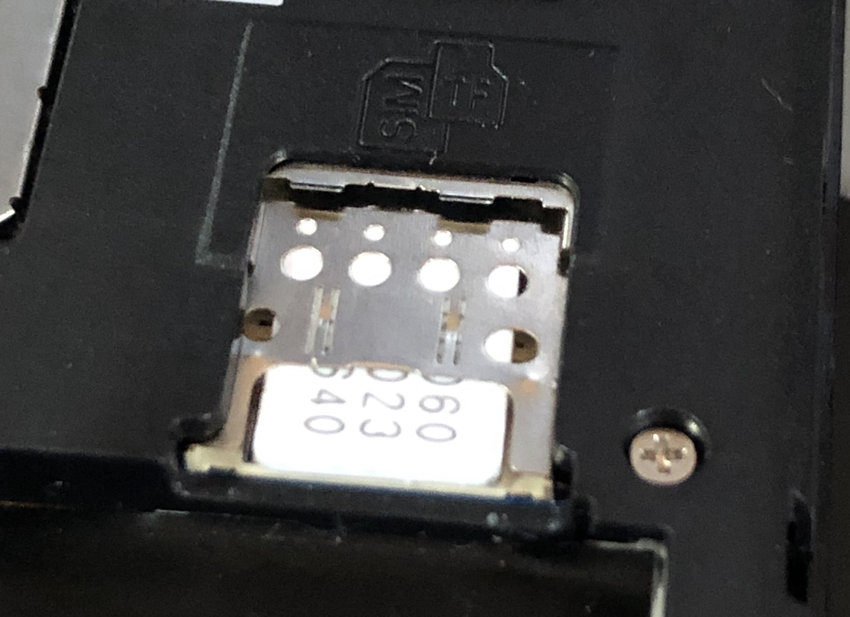

How far should I insert the SIM card?
See pic. I can push the SIM card further even until it's almost completely hidden by the metal. Either the way in the pic or completely inserted, the SIM card is not recognized by Ubuntu Touch or by postmarketOS.
Is this the correct way?
Is there an easy way to pull the SIM card out aside from using a sticky tape?

(02-05-2020, 07:42 PM)pajux Wrote: See pic. I can push the SIM card further even until it's almost completely hidden by the metal. Either the way in the pic or completely inserted, the SIM card is not recognized by Ubuntu Touch or by postmarketOS.
I'm not sure but it looks like you have a nano-sim, and the phone needs a micro-sim. If that is the problem try to get an adapter, they usually come with the sim card when you buy it.

Welllllllllllllllllllllll  *checks the Wiki/description page once more*
Quote:SIM Card: Micro-SIM
And I do have a Nano SIM..
That explains it all! Thanks!
