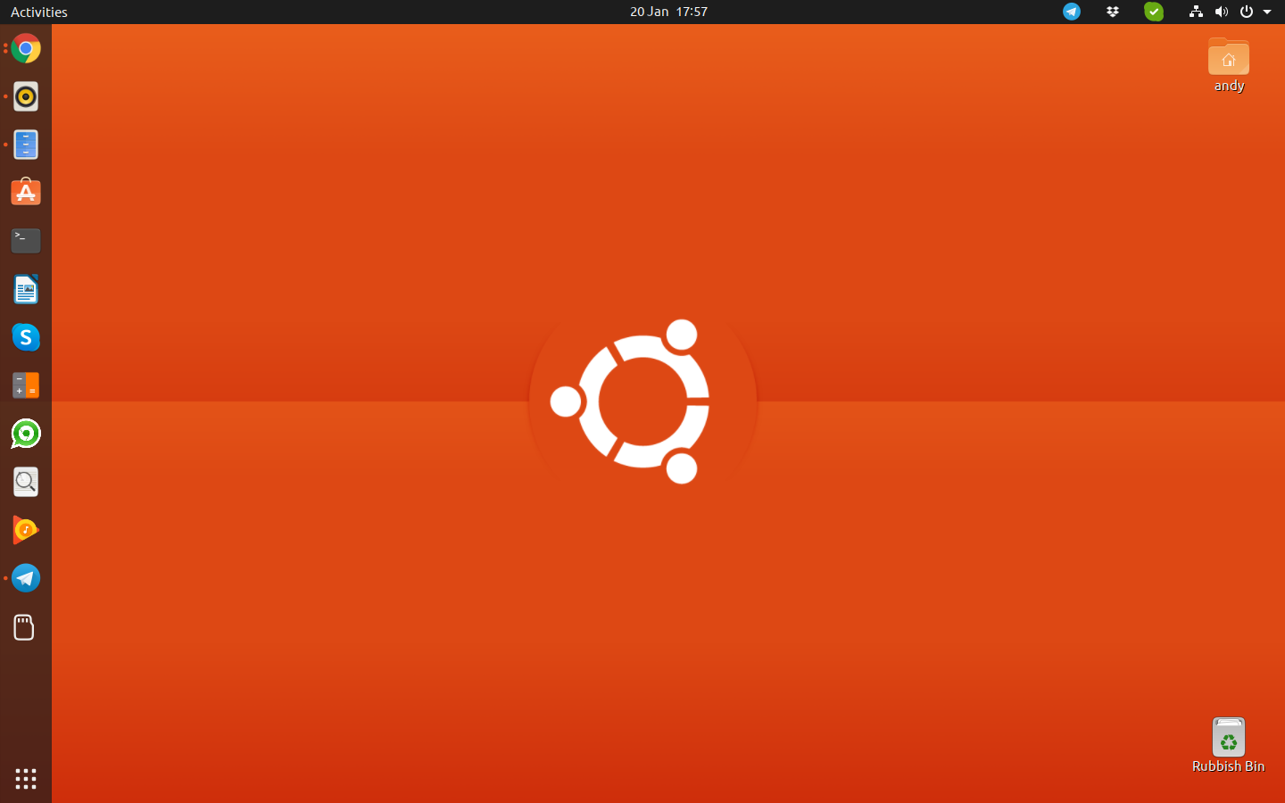

Anyone else managed to have a nice Ubuntu desktop like attached screen shot from my desktop
.png   Screenshot from 2020-01-20 17-57-55.png (Size: 95.2 KB / Downloads: 576)
.png   Screenshot from 2020-01-20 17-57-55.png (Size: 95.2 KB / Downloads: 576) with a side panel or is it just me?

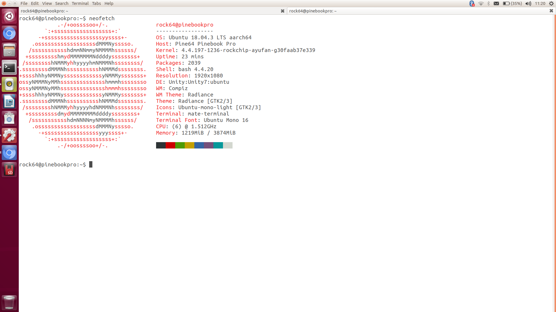

Forgot the power of Alt and f2 Of course!! I rarely used this but this worked
That located the terminal! and other apps I needed which I could then pin to the unity. See attachments
.png   Screenshot from 2020-01-27 11-20-57.png (Size: 180.91 KB / Downloads: 476) [attachment=1601]
All that does not seem to work despite re running the trackpad updater is the right click..will work on that now
