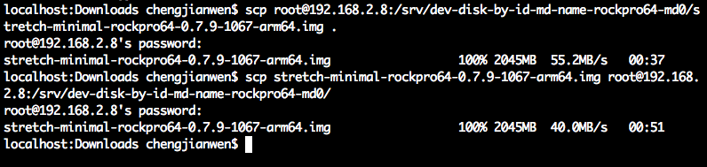

I trans a file with ssh, the speed is ahout 60-70MB/s, I don't kown is there any method to make it more fast.

Over SMB? you may wish to try some tweaks, these at the very least:
min receivefile size = 16384
write cache size = 524288
getwd cache = yes

I use ssh(scp) from my Macmini host directly, and there is no swich/router.
board is Rockpro64/2G.
