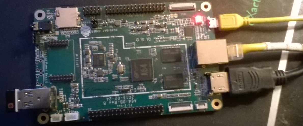

        Got it yesterday and I was looking forward to seeing what it can do. I created the bootable card and set up everything to get it to go. I put the Ethernet cable, the monitor, a mouse and finally the plug to my tablet. The plug has a thick cord and is powerful enough to run anything. Including my Pi2.
So the red light comes on, the monitor tries to get a picture and then.. NOTHING. No picture, no nothing. Help?
Try booting with only power and HDMI connected to see if thats the problem. Otherwise there has been reports of the Pine being picky with the screen connected.

I had the same. Got mine yesterday too. Tried all the available images, but nothing appeared on my monitor. I thought it would be broken. Then I searched this forum, and it's a known issue. I use a HDMI to DVI converter cable, to connect to a monitor. It won't work. Very dissapointing! I connected it to my TV, by real HDMI, and I had a picture. So I know now that the board works, and eventually I want to use it as a multimedia player, but for now it's useless!

Still nothing. Even put in the plug without the monitor and THEN plugged in the monitor. I'm trying to run lollypop on it. Should I try a different OS?

Your experience mirrors my own... I flashed the android image to my SD card with the win32 disk imager method which I have used to great success on several raspberry pis. I tried 2 different micro USB power supplies, a LiPo battery, a PC power supply with an adapter to connect to pin 2 and 6 on the e bus. All to no avail. I was about to give up but after reading dozens of threads I went back to the SD card. Verified my SD card with H2testw which it passed. Re-flashed using the phoenix utility. The flashing failed two times but was successful on the third. At least then I got the Pine64 Logo. Still working on it but I am now at least confident that I can get it to boot.
Try the Phoenix Card burn method...

Used Phoenix to write it and nothing. I'm thinking about Win32 Imager now.

When I wrote Android back on it and plugged it in, the screen is black and the power light on the monitor flashes.
