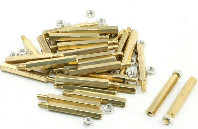

 I'm going to use brass standoffs. l'll use some small ones (something like 8mm) below the board, and taller ones above. In the picture that started the thread, the hex bolts are only used to hold the acrylic slabs together and some kind of plastic piece is used to attach the RasPi to the slab. I decided to have the standoffs do both functions.

I should mention, I wanted to go with a bit thicker than a 1/8" (3.17mm) acrylic piece, but the length of the threaded part of the standoffs stymied me on this. The male-side threaded part is only 6mm, so if I got a 1/4" (6.34mm) acrylic piece the standoff hex screw wouldn't reach all the way through.
If you wanted to get slightly more complicated, you could go with any thickness of acrylic you like, and just make sure you get the bottom standoff screws as female on both ends instead of m/f. That way you can run a regular screw (of an appropriate length) into the top and bottom of the unit. So it'd end up looking like this:
Male screw (down through the acrylic piece into the standoff)
______
Top acrylic piece
______
1" m/f standoff screw  (or however long you like based on how much headroom you want/need) with the receive male side pointed up to receive the top screw
______
Pine64
______
8mm f/f standoff screw
______
Male screw (up through the acrylic piece into the standoff)
Adding whatever washers and whatnot you like between any of the junctions.
This process will work only for single units. If you want to stack more than one, you would need to either stick to 1/8" acrylic and use m/f standoffs, or find a m/m screw to join each layer.

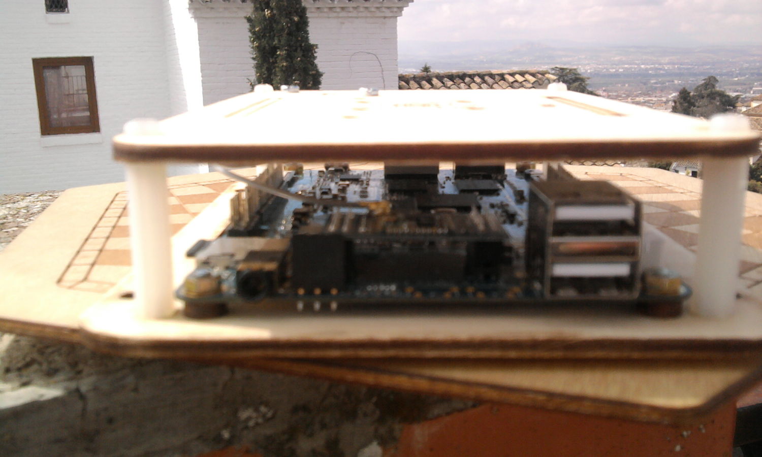

I also develope one open model enclosure  ...
25mm nylon HEX standoffs  And VESA holes adapter..
Bye
my open housing can be found here http://forum.pine64.org/showthread.php?t...08#pid3808. The cost is only $ 11.50 for a pine. For the second Pine will be added $ 3.70 for the spacers.
