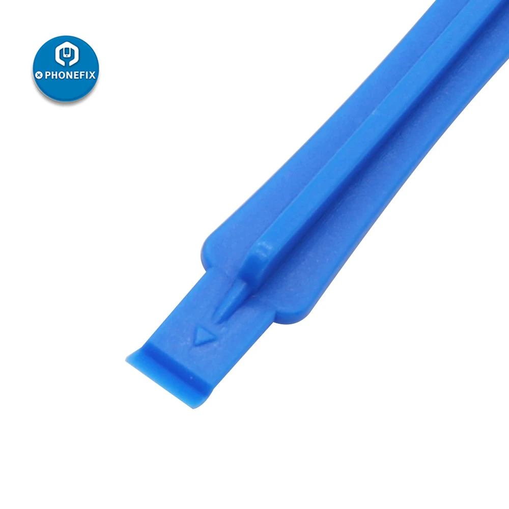

to outline, as best i can, what i found to make removing the screen easiest is to have 2-4 of these kind of pry tools: https://ae01.alicdn.com/kf/Hb26e538d13df...ar-Pry.jpg i recommend having several b/c one side can chew one of these up pretty bad. since i only had 2, i used a knife to clean up the pry edges between each side.
what i did was start with the "top side" where the buttons and ports are. once i was able to get it into the space between the screen and bezel, i was able to move the pry tool from corner to corner and release the tabs. from there i moved in a rotation, going to the bottom edge of the display and separating that side, then the next short side, and finally the last long side.
be patient and take your time, but you can have it done within 10-15m.

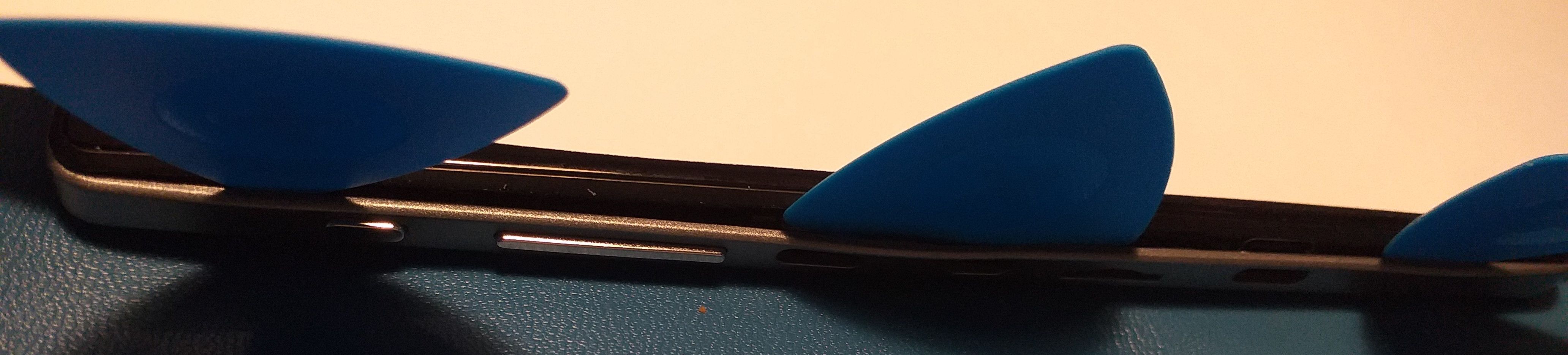

Thanks, starting with the top side is the easiest but you really need a pry tools for that (I only break 2 tabs).
Since moving the pry tools in the corner may be difficult, I opted to pry near the speaker for the side with the front camera (see the disassembly guide)
I've taken it apart with a couple guitar pick-type tools. snapped a lot of the plastic tabs that secure the back to the front, but no damage to the screen.
