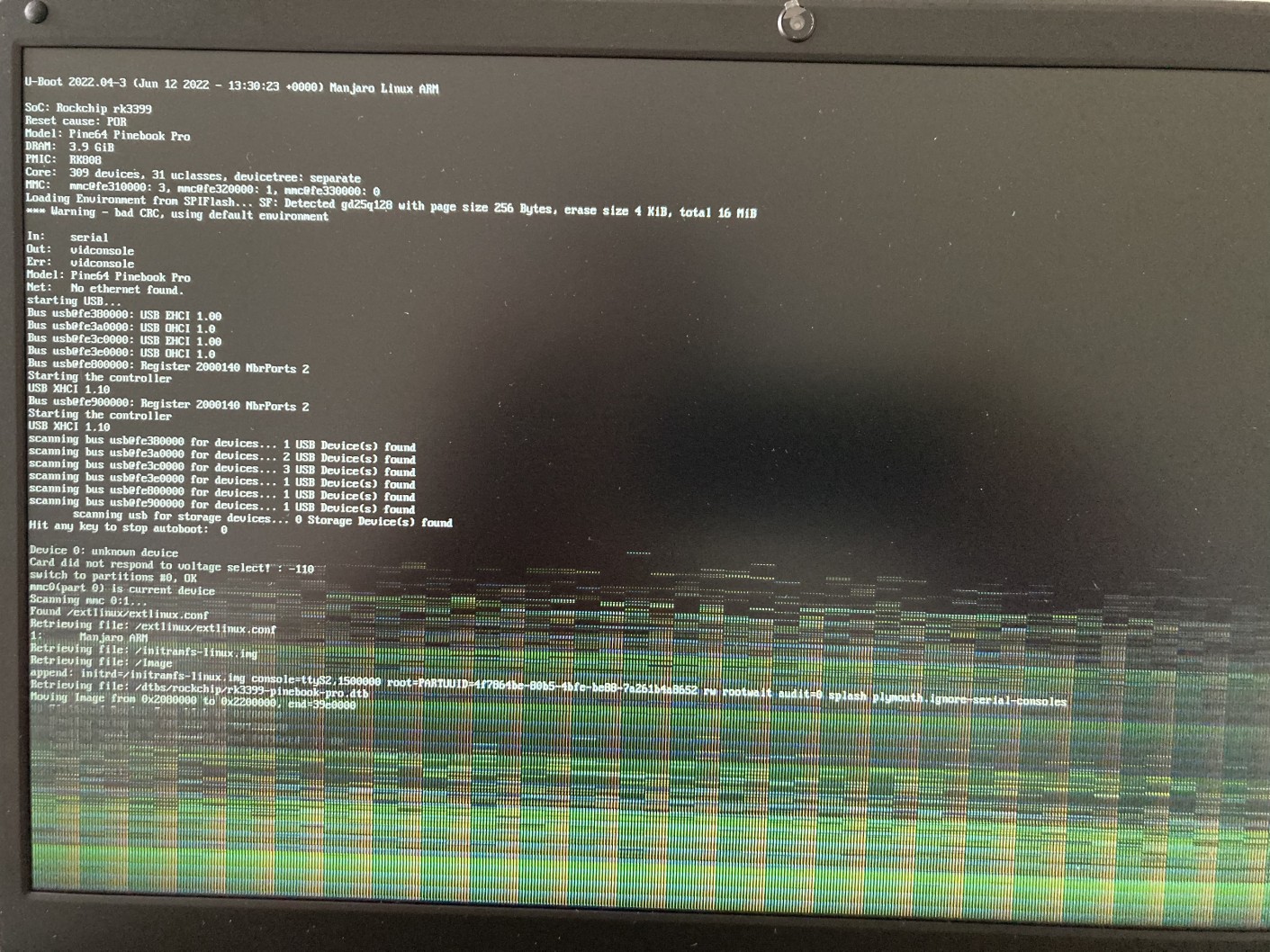

May be, I used the wrong "name" for the boot info screen. Here is a photo of the screen before it goes black with the blinking cursor and then flashing orange-green power LED.

You are right, that is a uboot screen

My guess is that uboot is finishing, the OS (manjaro xfce ??) has a bad dtb (or maybe initrd)
To really know you have to see a serial output from uboot
