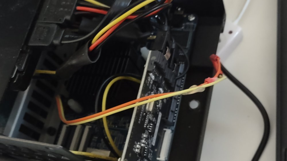

pretty simple.   take pair of jumper wires, put in a 10K ohm resister across one end (I cut the leads down), cover it with shrink.  Take the other pair at the other end.  put them on pins 4 and 6 (5v and ground) but any 5v and ground should work.  I put a bit of hotglue on them so it's easier to get them on together.   see pic
