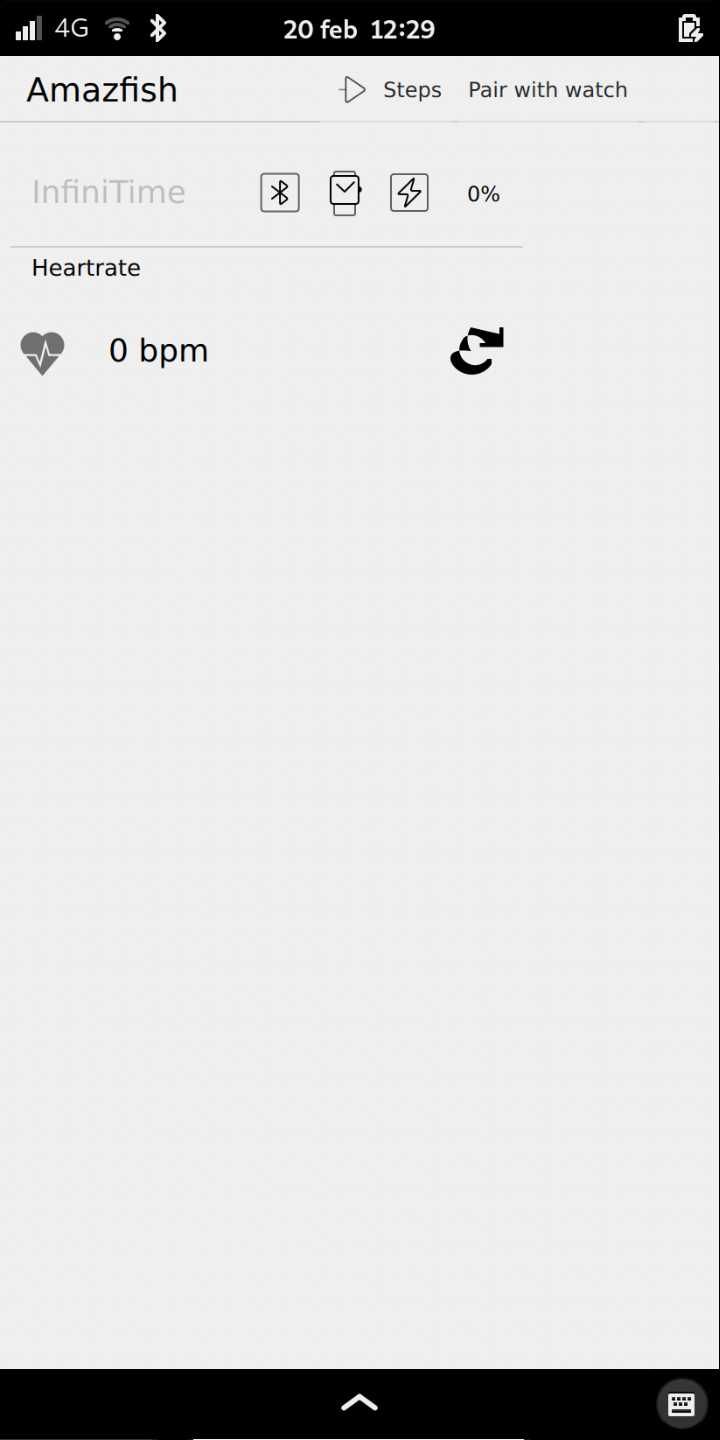

I also built it on Mobian. The missing dependencies are packaged in debian. Installing them actually works.
sudo apt install qml-module-qt-labs-settings
The app mostly works, but it looks kinda ugly compared to the screenshots, and I can't figure out how to open the settings menu.
