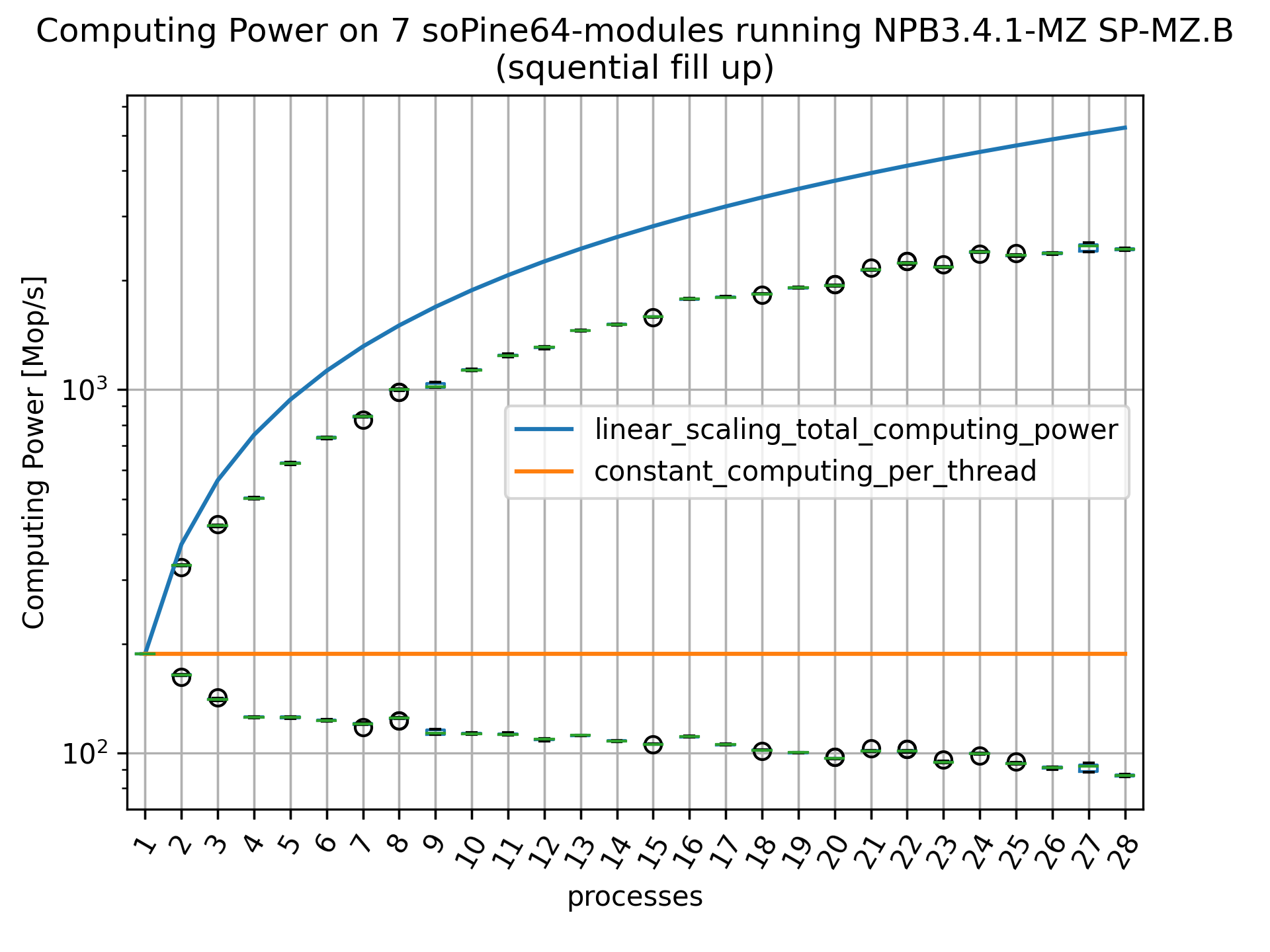

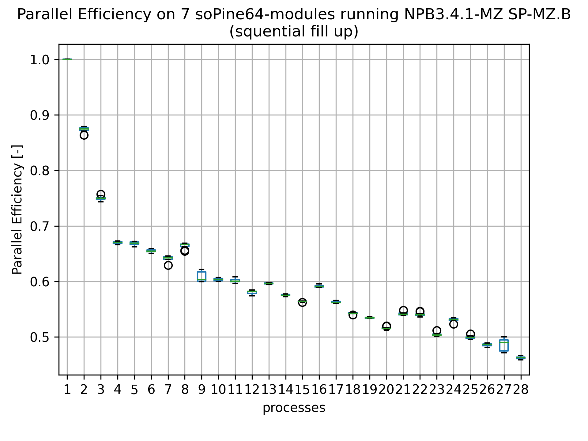

I did run the NPB3.4.1-MZ Benchmark on my cluster of 7 compute modules. Here are the results for SP-MZ Class=B:
[Image: attachment.php?aid=1997][Image: attachment.php?aid=1996]

For comparison:
My Intel Core-i5 5300U needs 72 seconds on two cores to complete the benchmark.
I plan on doing some more benchmarks, let me know what you think!

.png   computing_power_benchmark.out.png (Size: 193.9 KB / Downloads: 1,600)
.png   parallel_efficiency_benchmark.out.png (Size: 118.54 KB / Downloads: 1,538)
So with 20+ threads the runtime was sub 100s? A bit hard to tell due to the scale of the y-axis.
Thanks for making these benchmarks Smile
surprised at the diminishing returns of >3 modules...
That's actually cores/threads. So >1 module, but I suspect something else is at play there...
i was assuming each module is 4 threads, so >3 modules or >12 threads
