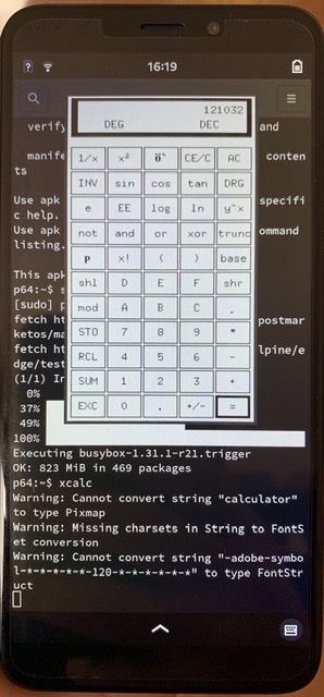

Still off topic, but FYI here is a screenshot of running xcalc under phosh which works perfectly.
.jpeg   8840F24A-D7A2-4F65-A137-54A620FBC245.jpeg (Size: 73.88 KB / Downloads: 867)
