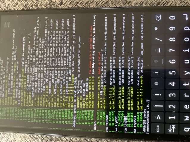

(09-13-2020, 02:49 AM)Helium75 Wrote: Good morning,
I copied and ran the scripts today (and adjusted the permissions to make sure that the script can be executed / write files ) but I still have the same issue - no sim card installed.
I also enhanced the delay to 40 seconds - still the same issue.
Is there a way to access the console or watch the boot process ?
Edit: I checked the log with dmesg. It seems like the system connects the modem 4 times and shuts it down after the modem didn’t respond rdy in time . This seems to be odd for me . I attached a “screen shot” if anyone is interested .
#20
I'm seeing the same, I ssh'd in to mine
[   15.085097] IPv6: ADDRCONF(NETDEV_CHANGE): wlan0: link becomes ready
[   21.503964] usb 3-1: new high-speed USB device number 2 using ehci-platform
[   21.851056] usbcore: registered new interface driver cdc_wdm
[   21.886299] usbcore: registered new interface driver option
[   21.886401] usbserial: USB Serial support registered for GSM modem (1-port)
[   21.886936] option 3-1:1.0: GSM modem (1-port) converter detected
[   21.887508] usb 3-1: GSM modem (1-port) converter now attached to ttyUSB0
[   21.887827] option 3-1:1.1: GSM modem (1-port) converter detected
[   21.890735] usb 3-1: GSM modem (1-port) converter now attached to ttyUSB1
[   21.891123] option 3-1:1.2: GSM modem (1-port) converter detected
[   21.892121] usb 3-1: GSM modem (1-port) converter now attached to ttyUSB2
[   21.892486] option 3-1:1.3: GSM modem (1-port) converter detected
[   21.893593] usb 3-1: GSM modem (1-port) converter now attached to ttyUSB3
[   21.915879] qmi_wwan 3-1:1.4: cdc-wdm0: USB WDM device
[   21.918735] qmi_wwan 3-1:1.4 wwan0: register 'qmi_wwan' at usb-1c1b000.usb-1, WWAN/QMI device, ea:88:bf:39:82:cd
[   21.918971] usbcore: registered new interface driver qmi_wwan
[   31.713702] avdd-csi: disabling
[   31.713771] usb-5v: disabling
[   41.447181] modem-power serial1-0: The modem didn't send RDY in time
[   41.447432] modem-power serial1-0: Forcibly cutting off power, data loss may occur.
[   41.447504] modem-power serial1-0: power up failed
[   41.491477] usb 3-1: USB disconnect, device number 2
[   41.492117] option1 ttyUSB0: GSM modem (1-port) converter now disconnected from ttyUSB0
[   41.492221] option 3-1:1.0: device disconnected
[   41.493108] option1 ttyUSB1: GSM modem (1-port) converter now disconnected from ttyUSB1
[   41.493228] option 3-1:1.1: device disconnected
[   41.494052] option1 ttyUSB2: GSM modem (1-port) converter now disconnected from ttyUSB2
[   41.494192] option 3-1:1.2: device disconnected
[   41.495029] option1 ttyUSB3: GSM modem (1-port) converter now disconnected from ttyUSB3
[   41.495270] option 3-1:1.3: device disconnected
[   41.502275] qmi_wwan 3-1:1.4 wwan0: unregister 'qmi_wwan' usb-1c1b000.usb-1, WWAN/QMI device
Interestingly looking at 'journalctl -u ofonod' I can see ofono does read the IMEI correctly
Sep 16 16:01:20 PinePhone ofonod[2929]: Ignoring Plugin to read EFACL from SIM
Sep 16 16:01:20 PinePhone ofonod[2929]: CREATE SFOS MANAGER PLUGIN
Sep 16 16:01:38 PinePhone ofonod[2929]: Got IMEI 8676980xxxxxxxx
Sep 16 16:01:38 PinePhone ofonod[2929]: service capabilities 4
Sep 16 16:01:38 PinePhone ofonod[2929]: sim supported 2
Sep 16 16:01:38 PinePhone ofonod[2929]: Use modem qmimodem
Sep 16 16:01:39 PinePhone ofonod[2929]: Requested file structure differs from SIM: 6fb7
Sep 16 16:01:40 PinePhone ofonod[2929]: Unable to read waiting messages numbers from SIM
Sep 16 16:01:40 PinePhone ofonod[2929]: Unable to read mailbox identifies from SIM
Sep 16 16:01:40 PinePhone ofonod[2929]: 0x226978 online
Sep 16 16:01:40 PinePhone ofonod[2929]: slot_gobi_slot_set_data_role
Sep 16 16:01:40 PinePhone ofonod[2929]: 2
Sep 16 16:01:40 PinePhone ofonod[2929]: Post online 0x226978
Sep 16 16:01:40 PinePhone systemd[1]: Started Telephony service.
Sep 16 16:01:41 PinePhone ofonod[2929]: LTE attach IP type: 0
So I don't think the "No SIM" message is related to ofono, looks like the sim is presenting something unexpected to ofonod.
