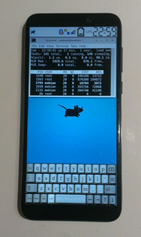

Quick first impressions: Pretty useable despite the small buttons. No browser so installed firefox without issue. Youtube playback is very smooth but no sound. I see a modem manager but I guess there is no phone app here? Some window tiling would be nice but already a promising alternative to phosh  Smile
