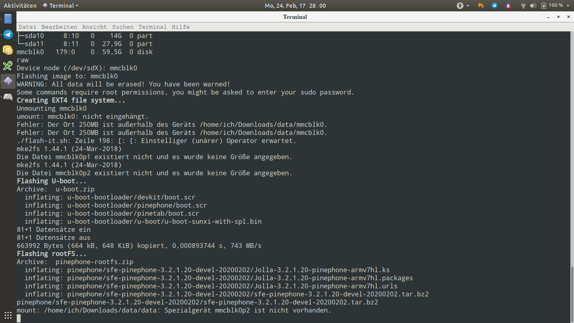

the flash-it finish successful, but nothing written on sd card
.png   Bildschirmfoto von 2020-02-24 17-28-00.png (Size: 273.23 KB / Downloads: 760)
I have the same issue: empty SD card after flashing.
(02-24-2020, 11:24 AM)cefre00 Wrote: I have the same issue: empty SD card after flashing.
Seems hat Sailfish script won't work any more. And no one has a solution.
