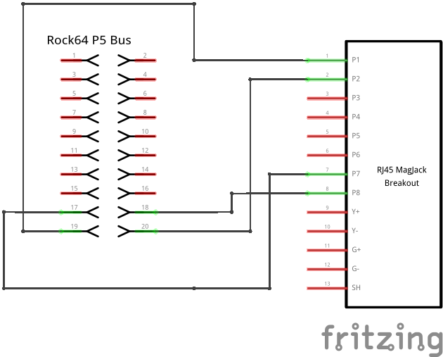

Can you make a drawing how you wired up the center tabs of the transformers?
(04-10-2018, 03:15 AM)xalius Wrote: Can you make a drawing how you wired up the center tabs of the transformers?
Here's a little schematic of the 4 connections I made. (I know it's missing pins 21 & 22, I didn't know how to add them but they're not being used yet).

I'm also having nojoy on using the digikey magjack directly, attached is my schematic. I've enabled the overlay, no link on the switch or eth1 device.
[Image: view?usp=sharing]

I bought a magjack too. But eth1 does not work. I tried Armbian and ayufan's latest release.
I see in the output of the ifconfig command that there are transmitted packets and bytes, but there are no received (RX packets:0     RX bytes:0).
If two jumpers connect the receive to transmit on connector P5 (17+19 and 18+20), the number of bytes received should change?
In my experiment, the number of bytes and packets received was 0.
http://files.pine64.org/doc/rock64/ROCK6..._Board.pdf
If someone created it according to the circuit diagram above and it worked, please report it.
Initially, this circuit diagram itself would be wrong.
Because, it became to work after adding a terminating resistor.

#20
Do you have enough experience to understand by looking at the circuit diagram?
For example, it is a circuit diagram as in the above post.
https://forum.pine64.org/showthread.php?...4#pid37014
If so, as an example, I can present a circuit diagram that I made and working well.
