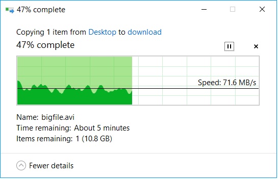

Through Samba, I got on average 70MB/s when copying from Win 10 to Rock64 with conventional HDD.
[Image: attachment.php?aid=1125]

/dev/disk/by-id/ata-ST4000DM004-2CV104_ZFN0B7VM-part1 /srv/dev-disk-by-id-ata-ST4000DM004-2CV104_ZFN0B7VM-part1 ext4 defaults,nofail,user_xattr,noexec,usrjquota=aquota.user,grpjquota=aquota.group,jqfmt=vfsv0,acl 0 2
# <<< [openmediavault]
and finally
root@rock64:/srv/dev-disk-by-id-ata-ST4000DM004-2CV104_ZFN0B7VM-part1/test# uname -a
Linux rock64 4.4.77-rockchip-ayufan-136 #1 SMP Thu Oct 12 09:14:48 UTC 2017 aarch64 GNU/Linux
Thanks everyone for helping, I'll probably stick with OMV since I really like the webUI
