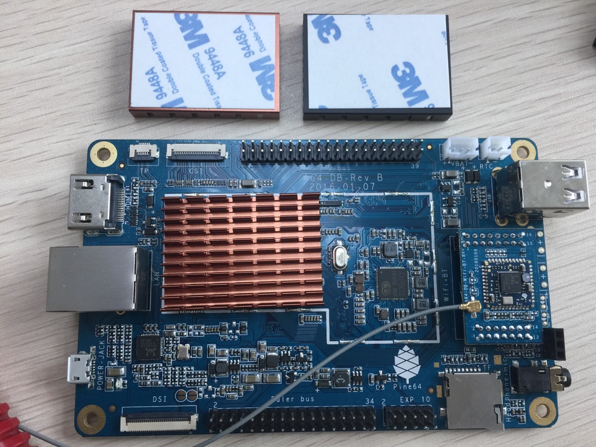

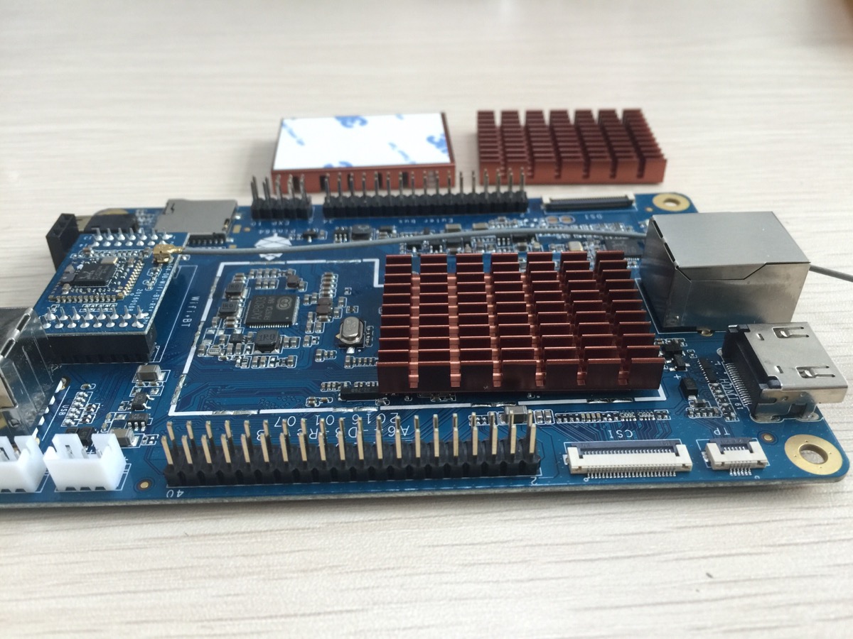

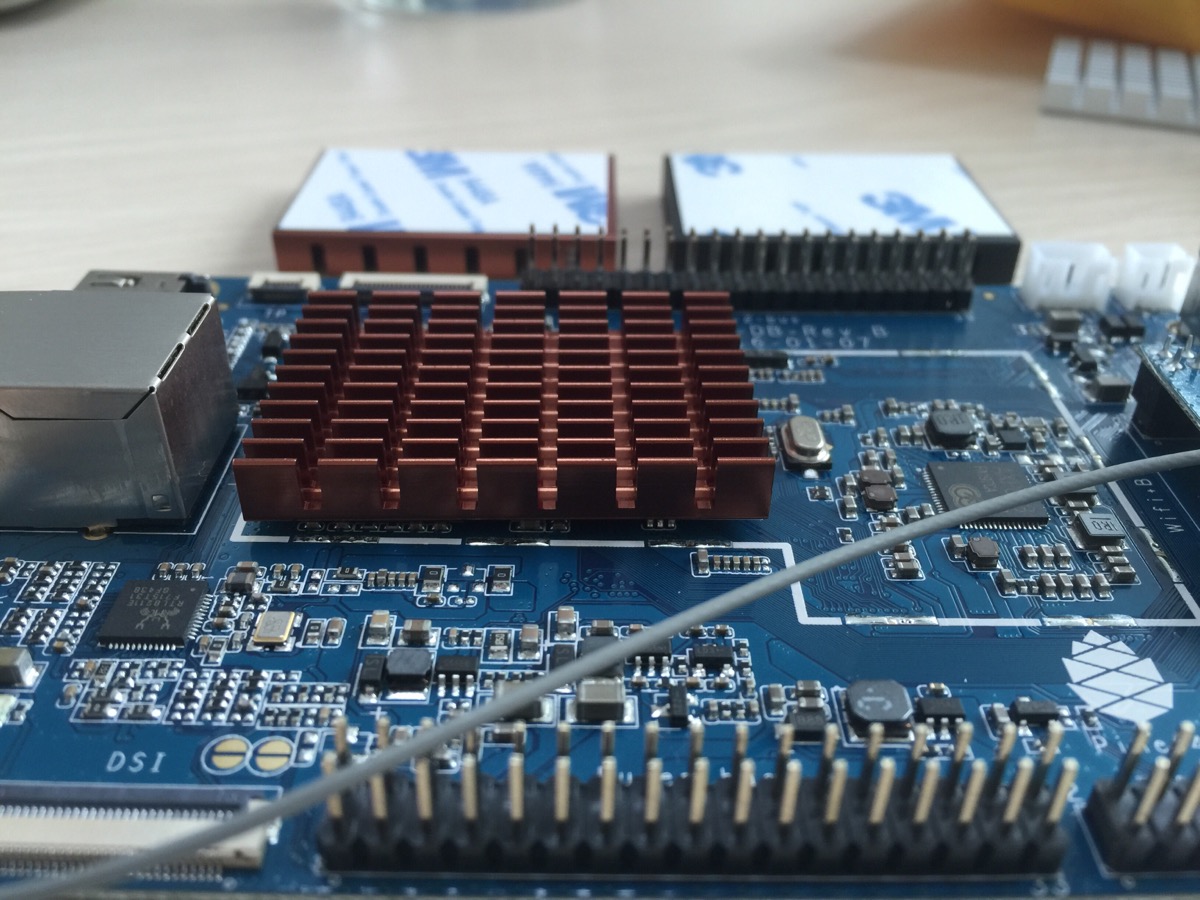

Here are the heat sink samples photos, Aluminum with copper plated. We will need to characterize the heat sink and will takes few week.

(03-15-2016, 07:52 PM)tllim Wrote: Here are the heat sink samples photos, Aluminum with copper plated. We will need to characterize the heat sink and will takes few week.
Looks good and efficient but I wonder whether you take care of the slightly different height of DRAM and SoC?
