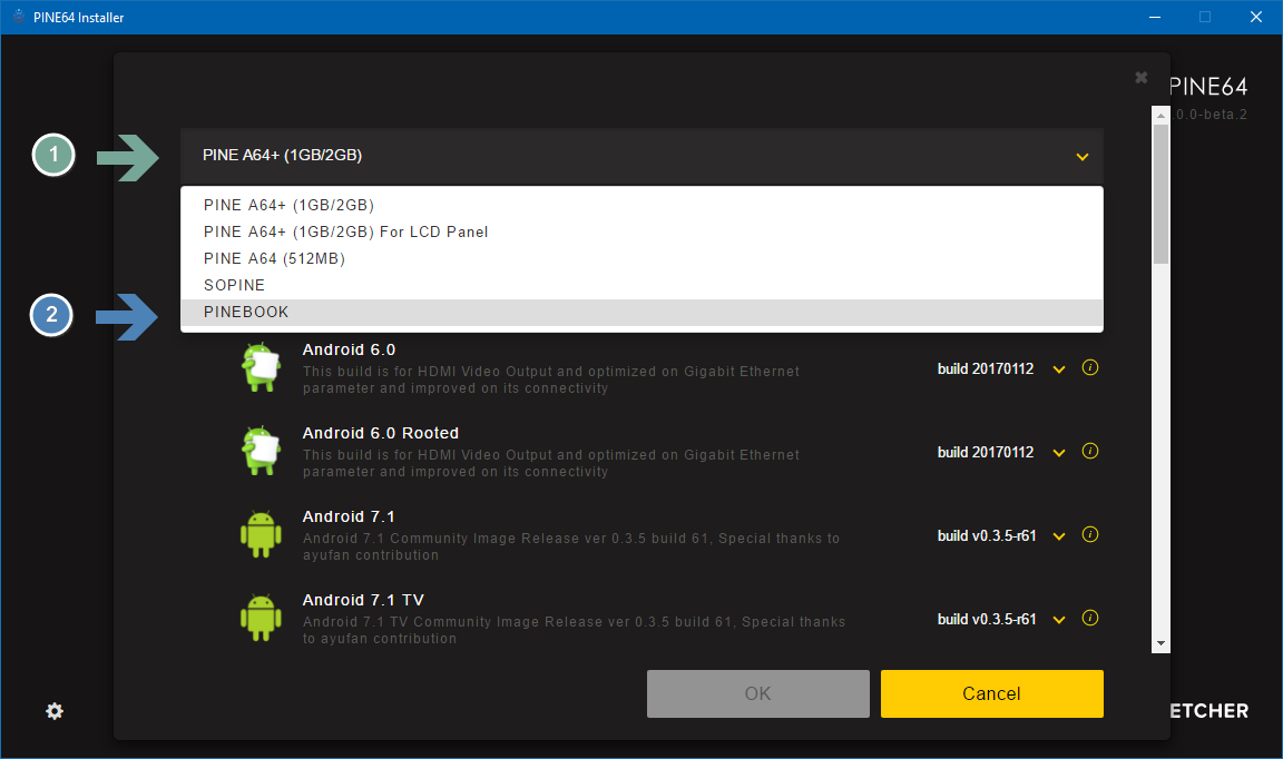

Ok, I'll first ask the really, really dumb question... because all have use have done this one time or another with the pine64 installer... Wink Did you make sure that you choose pinebook from the drop-down menu at the top? It defaults to the pine64 images, which won't work on the pinebook.

"Did you make sure that you choose pinebook from the drop-down menu at the top?"
I did not. I have no excuse.
Pressing on.
