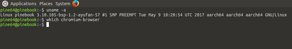

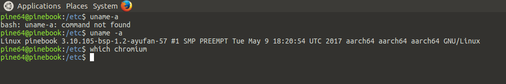

(05-09-2017, 03:12 PM)ayufan Wrote: The SECCOMP is disabled in latest build.
Is Chromium actually supposed to be installed in the 0.5.1 build (as the notes suggest)? I just tried it out, and no chromium when running from the microSD... or is it only installed when you load 0.5.1 onto the eMMC?
chromium-browser
Homepage: https://ayufan.eu
Releases:
Rock/Pro 64/Pinebook Pro: Linux; Chromium OS
So/Pine A64/Pinebook: Linux; Android 6.0; Android 7.1
Buy me a Beer
(05-11-2017, 02:13 AM)ayufan Wrote: chromium-browser
Apologies... chromium-browser... but it is still not present on build 0.5.1 / 57 (in contradiction to the release notes)
