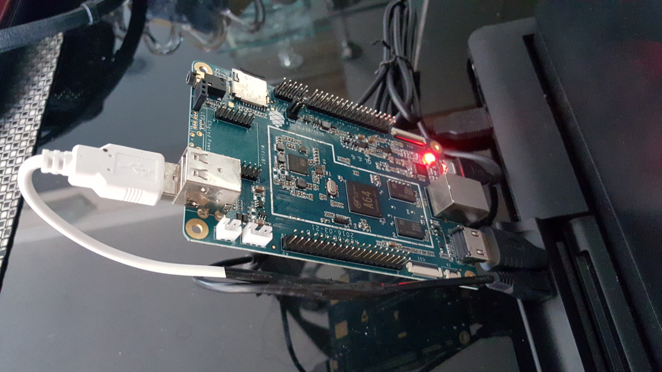

Hello John,
Thank you! It worked!
It was great to find someone that understood and spoke my same language (Not linux only).
Your hints worked perfectly.
And yes, the stress levels went down at the moment that I saw the Remix Os logo flashing in the screen.
Ps.: I would like to share my experience. I am using the Pine64 1GB + Remix OS, on a Motorola Atrix Lapdock. I bought the lapdock on the web for less than US$20, and with it I have a 720p 11" screen, USB HUB, Speakers, Trackpad, Keyboard, Battery Pack and a form factor of a very slim notebook. I surely recommend it for anyone that fools around with single board computers. ;-)
Hbtr
