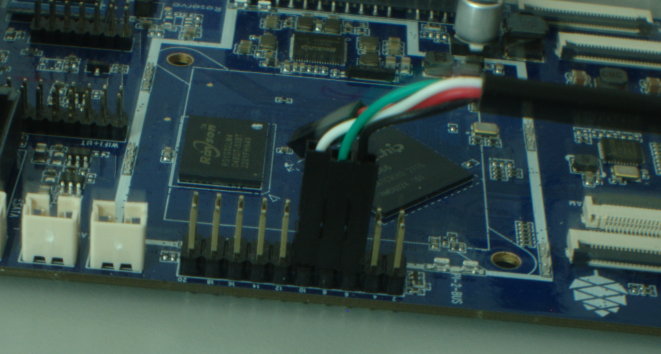

Although I did not attempt to connect via uart this time, when I've done so in the past I've followed that wiki's information on the pin connections. I'm using this device
circuit.rocks/usb-to-ttl-serial-cable-debug-console-cable-raspberry-pi.html
And, as per the wiki, connecting the black socket to pin 6, the green to pin 8, and the white to pin 10.

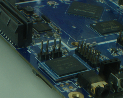

which power supply do you use ? what is the state of the jumper next to the eMMC connector (there should be a jumper on the one closest to the edge, there should be no jumper on the second one)? How is the image recorded on the SD card ?

Neither jumper is jumped.

Write down the image with a program (the forum often indicates programs for recording that users use), dd often gives incorrect results and problems at startup (if you need details, why it is not recommended to use dd - see the armbian forum, there is a lot of information there and there is a special topic with details). Show a photo of your jumpers (which are next to the eMMC connector), there should be a jumper on the one closest to the edge, if I don't confuse the prayer, without a jumper, the launch from SD\eMMC will be blocked (disabled).

Here is an image of the jumpers, and of the uart pins attached to the appropriate gpio pin.
