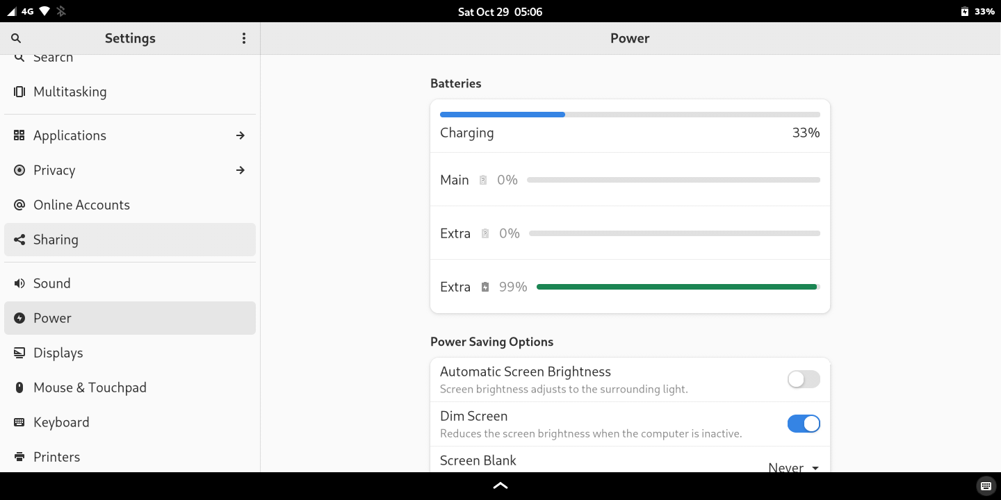

The image below shows the PinePhone (+ PP Keyboard) almost fully charged.

For me, on Mobian and PostmarketOS it's started displaying 25% on a full charge.
My current theory is it's due to changes in how the UPower daemon calculates the display percentage. Have a look at my thread about it:
https://forum.pine64.org/showthread.php?tid=17740
