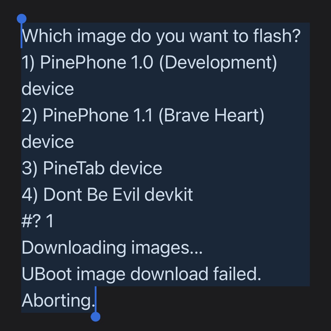

hi
i am trying to install sailfish but keep getting stuck here
what am i missing? many thanks
Which image do you want to flash?
1) PinePhone 1.0 (Development) device
2) PinePhone 1.1 (Brave Heart) device
3) PineTab device
4) Dont Be Evil devkit
#? 1
Downloading images...
UBoot image download failed. Aborting.
3) PineTab device
#? 1

Do you really have a dev pinephone? It seems unlikely. If you have an original or community pinephone choose 2; if you have a pinephonepro choose 5, and try again.

I got the exact same error trying to run the script on an arm machine. I decided to try it on my x86 laptop and it's running fine

tried selecting all the other options and get the same output

(12-23-2022, 01:46 PM)ommm Wrote: [quote pid="115086" dateline="1671811015"]
where did you get the flash-it.sh? Github can be very confusing and there seem to be outdated versions there too. Go to https://github.com/sailfish-on-dontbeevil/flash-it Click the green 'code' button and Download Zip. This version works for me now.
