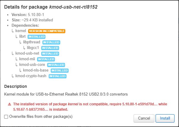

@wilsonYan ,  How to update this:
Details for package kmod-usb-net-rtl8152
Version: 5.10.80-1
Size: ~29.4 KB installed
Dependencies:
kernel VERSION INCOMPATIBLE
librt INSTALLED
libpthread INSTALLED
libgcc1 INSTALLED
kmod-usb-net INSTALLED
kmod-mii INSTALLED
kmod-usb-core INSTALLED
kmod-nls-base INSTALLED
kmod-crypto-hash INSTALLED
Description
Kernel module for USB-to-Ethernet Realtek 8152 USB2.0/3.0 convertors
The installed version of package kernel is not compatible, require 5.10.80-1-e591d70d… while 5.10.67-1-b9373165… is installed.

(11-26-2021, 08:01 PM)helpmerock Wrote: @wilsonYan ,  How to update this:
Version: 5.10.80-1
Dependencies:
librt INSTALLED
libgcc1 INSTALLED
kmod-mii INSTALLED
Description
Hiya, there is a semi-active fork of openwrt at https://github.com/lucize/openwrt/tree/rk3328 which supports building for the rock64.
