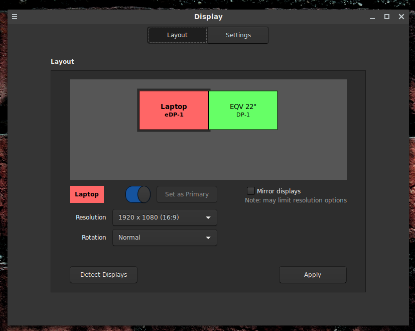

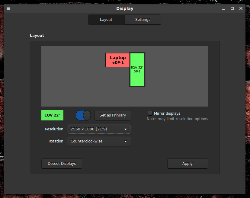

Got myself a USBC with alt mode the other day and video out worked without any problems, except running the HDMI to a 21:9 screen PBP wants to set the same display resolution to the 21:9 monitor as for the PBP screen which then becomes stretched. There are no other modes to choose from in the list of resolutions, so I'm wondering if its possible to set a custom resolution for the 21:9 screen somehow by hand?

I tried following these instructions: https://askubuntu.com/questions/377937/h...ion#377944
Screen resolution gets all weird.
Added screenshot of PBP standard resolution, and another where the custom resolution has been added. Does anyone understand why this happens?
