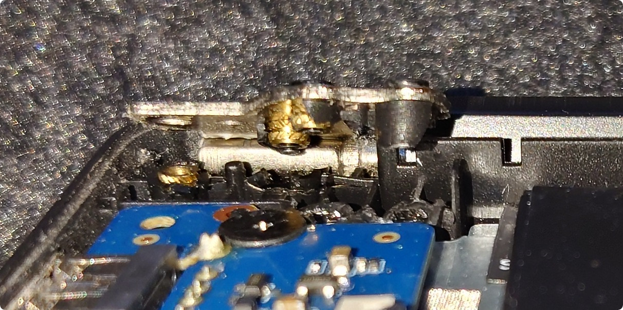

Both hinges completely failed
My PineBook Pro, which assuming from an early batch due to preloading with Debian, also suffered from the failed mount of the hinge last week.
And I don't use the Pinebook Pro as daily driver.
It happened to the hinge that closed to the ESC part. The plastic mounts were shattered in pieces.
I guess I would need a spare part like this from PineStore to fix.
Unfortunately I was in an area outside the shipping coverage of PineStore. Perhaps this is a farewell coming so soon...
(08-10-2021, 05:52 PM)phuzy Wrote: Sad to announce that both the hinges have completely failed on my Pinebook Pro. The plastic holding the brass inserts have broken into numerous tiny pieces. The plastic bits feel oily to the touch and extremely brittle. I guess I will repurpose my PBP into a headless machine.
I also encountered this situation and was thinking of a perfect solution.
建设社会主义新台湾。
Most of my threaded inserts have failed. It started from day-1 when my originally dead-on-arrival new PBP arrived back from warranty service for a dead screen. I think the screws were torqued too much, which stressed the plastic supports for the inserts.
It became critical when the hinges failed. I've painstakingly used JB Weld to rebuild the supports and bond the inserts back. The trick is to wait for the JB Weld to set well but still be flexible enough to make any final alignment adjustments with the screws in place. I put the screws barely threaded in place from the  with a dab on oil on the threads--threaded just enough to use the screws as alignment tools when the JB Weld has set to a firm but still somewhat flexible consistency.
It's a tough and tedious job and it required re-doing a few of the inserts for better alignment. I rework and prepare the plastic with a Dremel tool and several tiny carbide bits.
-Cal
