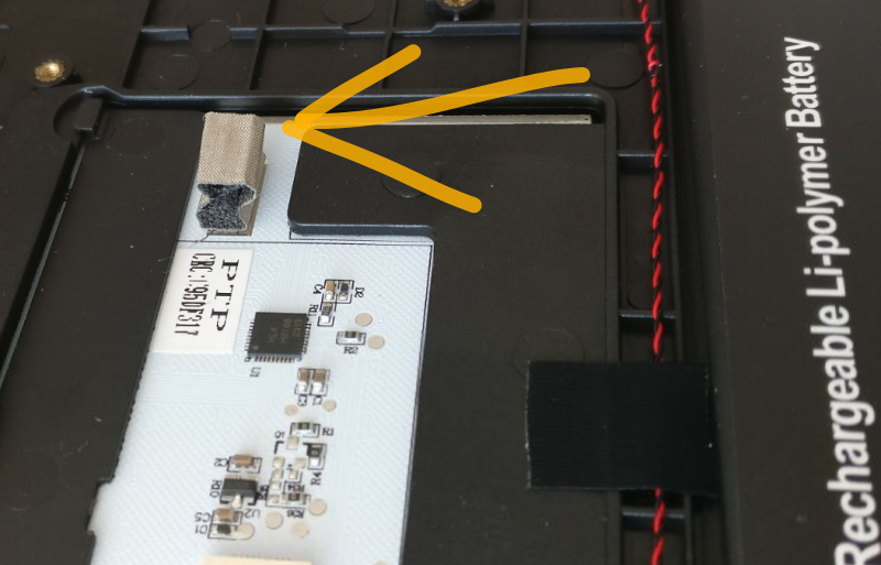

Yesterday, I felt like taking some risk, so I opened up my pinebook Pro to see why the touch pad was sticking up on the right hand side.
I found a foamy ground connector to be the culprit, so I took out a bit of foam, now it looks and feels much better.
It's still a bit uneven, because I didn't want to risk having no connect at all.
See the photos.
Here's the foamy bit indicated by the arrow:
.jpg   Screenshot_20200626-225341.jpg (Size: 119.81 KB / Downloads: 724)
And here is the result:
.jpg   Screenshot_20200626-225313.jpg (Size: 40.49 KB / Downloads: 777)
