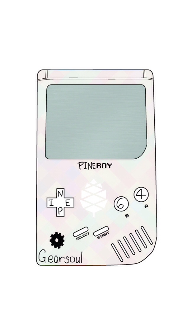

Soooo... Digging through some drawers, I came across my old Gameboy.
Consequently I have a large number of questions; apologies in advance?
I'm a complete newbie to modding, so I'm really gonna need some help here! n__n;; Please & thank you?
The DMG/Classic Gameboy (I presume external) dimensions googled up at 5.82 inches tall, 3.54 inches wide and 1.25 inches thick...
The Pine64 is 5 inches flat by 3.125 inches.
So, I think it might be possible to gut my Gameboy and squidgy the Pine64 and the battery into the case!? =D
I'd need help from Google, too, to actually *do* it, but I think this would be super cool! :3
Or would it? :0c How do I deal with potential overheating? Is it too small a space for this? Or would heat production not be significant enough to be of concern?
And what about data storage...
Awhile ago it was said the hard drive was 2.5"? A laptop one I believe.
And while it wasn't confirmed by Pine64, someone else said it would probably be 7mm thick?
Is that accurate? Would I be able to sneak a hard drive in there, too?
How big are the wifi/Bluetooth components? :0c The idea of connecting it to my (hand-me-down-i)phone to offload all my pictures(because my phone is weird or my laptop sucks(?) and it rarely shows up when I plug it in, making cleaning it out even harder) that take up a huge amount of my phones space is super appealing!
Or do you think it'd just be too tight to fit and it'd be a waste of money to add on additional components for this?
SkairkrohBule pointed out the USB ports stick out a fair bit, and thus gave me the idea of having them poke out of the game cartridge slot, so thanks for that! :D
(I wonder if I can use part of an old game cartridge as a cover for the slot, to protect the ports~ n__n Much as I love it, I'd probably sacrifice my semi-faded Pokémon Blue version for that job! Just so I can look at it all the time :P)
:0c I'll also have to look into replacing the screen, so it has a colour display...
Most results pertained to installing a backlight mod.
So then I wondered if I could fit a GBA screen into the case; I have an old GBA laying around somewhere, too! After that, while searching for (another hand-me-down) my GBA, I came across my (also hand-me-down 'xD) DS lite!
Now... That got me thinking... It would surely have a much higher quality screen/colour -- and *touchscreen!* =D
A bunch of googling later and I had the name of something else that I came across... SSD1289! :3
A 3.2 inch LCD touch screen(with some kind of card slot... Micro SD?) that I wouldn't have to carve out of another system and would be brand new! :D
I'd just have to remove the painted-on plastic screen so the whole thing is accessible/visible.
So, can someone tell me, am I completely barking up the wrong tree, here, or could this actually work?? :3
I also found a store that does modding/parts for retro consoles/handhelds:
http://store.kitsch-bent.com/
It has some stuff that would be important, like GBAmp and Soundpro kits to improve the volume and quality of the sound.
But then, perhaps I need not be constrained by (Classic Gameboy)DMG-specific hardware because I'm gutting it to stash the Pine64, and you guys might have some better suggestions for audio hardware? 0.0?
n____n;;; Sorry for this huge post, hope you guys can help me out!
Hey! Gearsoul! Long time no see! [Image: tongue.png]
I really like your idea to use a Gameboy case for your Pine. Sounds like you want to go further than that, though, and make it into a fully-functional portable unit.
If you've not done much modding like this before, you've given yourself a tricky first project. But that does not mean you should give up straight away. I am searching eBay for my own original Gameboy and intend also to try and do something similar to what you're doing, so maybe we can help each other out along the way [Image: smile.png]
A couple of things straight away - firstly, you will not need any of that Gameboy-related stuff (GBAmp, Soundpro kit). We can maybe re-route the speaker into the relevant connections on the Euler Bus on the Pine A64, since there is a port for that. You will basically be gutting out everything in the Gameboy save for the buttons and the speaker. The rest of the room will be needed for Pine stuff. And believe me, you haven't got a lot of room.
Secondly, hold off on buying that screen! The size may be good, but the screen will also need the Pine to have the necessary drivers in order to make it work. There was talk on another forum thread about Pine64 Inc making or commissioning a company to make them some small screens. This would be preferable to buying a random screen, as you could be sure it would work.
Thirdly, given the space constraints, you are probably better off in this instance buying a slightly larger micro sd card and running/storing everything from/on that. A hard drive would take up too much space.

I took a photo of mine so you can see the gap. As to the battery compartment, it's nearly the full depth of the Gameboy and about half the height nearly.
Photo! :3[Image: a3h2ko.jpg]
Thanks for the photo!
Yeah, the space occupied by the battery compartment might be an issue...I guess we won't really know how much of an issue until the Pines turn up...
Anyway, interesting! I am looking forward to tearing Nintendo's beloved first handheld apart! Big Grin
