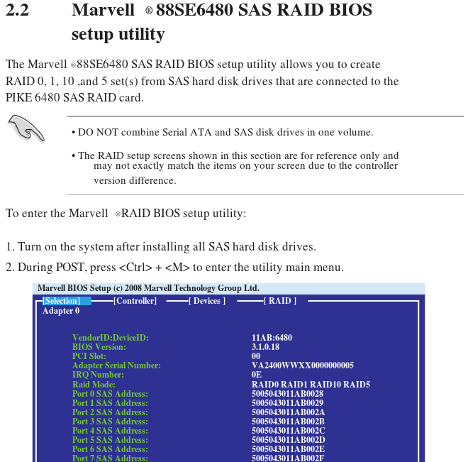

Hi! Probably, your card requires BIOS support which is impossible with this SBC. For the chip your card used there should be Marvell BIOS support, like I see in different product user manual.
[Image: attachment.php?aid=1441]
The cards which doesn't use dedicated BIOS support should work.
Also if you have spare hardware, you can try to insert the card into PCIe slot while the SBC is running, make a hotplug. If the hardware will not blow-up, probably you will got more information in kernel log.

Thanks for the reply.  I don't agree with what you're saying because this card does not have RAID capability (one of the reasons I bought it).  Here is the link to the manufacturer's page of the card.  The information you found is specific to the Marvell 6480 controller where the card in question has a Marvell 9480.  Not trying to nit-pick here but sometimes the devil is in the details, and I admit I could be completely wrong.
Anyways, I just got a serial adapter in the mail so I'll try seeing what all the fuss is about with this card.
Agree with you now. Looking into serial output right after power-on is a good place to start. The adapter needs to be setup for 1.5MBaud speed.
Will start a new thread for the serial output of this card.
If your PCIe card contains an option ROM or similar with x86 code to run on startup, that's usually a dealbreaker, unless your card vendor has option ROM firmware that runs on ARM
