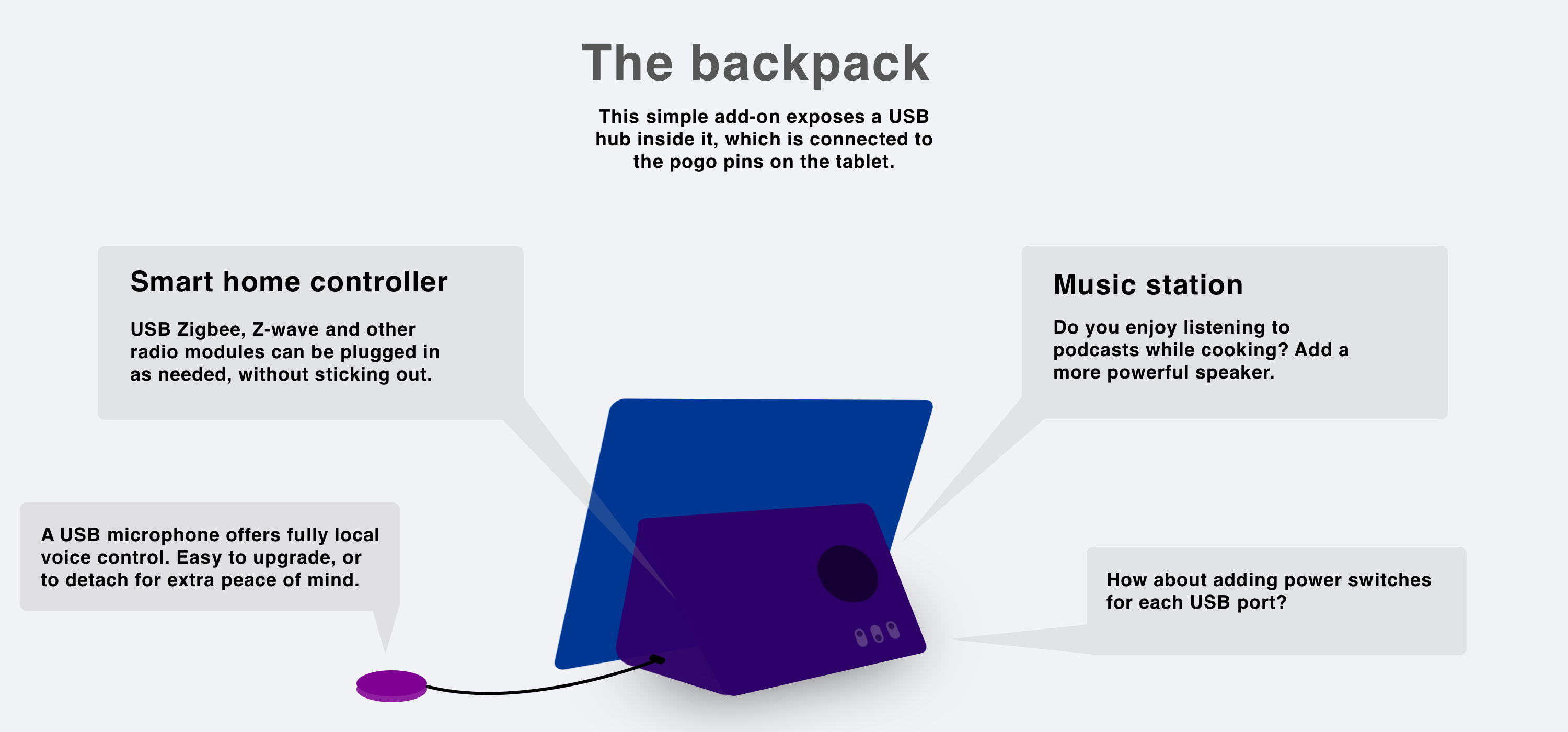

The backpack
Alternatively, a stand could be created that connects to the keyboard pins (which I read act as a USB 2.0 connector), and adds these radios that way. It could also add a speaker and microphone array to allow for fully local, privacy friendly voice control.
[Image: pinetab_backpack.png]
But then the downside would be that the tablet would have to stay fixed to that stand for the radio modules to be connected. If there was a built-in module, it could stay mobile and control the home at the same time.

OK. That's a wonderful use case. What about a USB dock stand with radios? Set the tab onto the dock, making certain there is a good USB connection and sturdy support. Tab is powered from dock.
It becomes less mobile, which might be an issue, though.
Either way, you're looking at a custom PCB for the radios, but this prevents your customer base having to open and install things in the tab internals. Unless you're considering a full custom solution where you supply the tab already with radio and software installed and working.

Hey @Paraplegic Racehorse, just to check, are you able to see the picture in the first post? It visualizes exactly what you say, so perhaps there is a misconfiguration on my server (happened before). Can you see it?

Yes. I can see the picture; and that is substantially similar to what I was thinking. Really, just a docking station with all the foo built into the dock.

Already move to PineTab forum. Likes your concept, when you need the USB docking pogo pins for your project, just PM me and I will ship some to you.

That's a pretty nice idea. The PineTab could detect the USB hub in the backpack. A slight variation on your theme: the tablet could have a built-in Zigbee radio, and the user could add additional radio modules in the dock (e.g. Z-wave usb stick).
It would make a lot of sense with voice. The builtin microhone could be used for voice control when mobile, and when docked it could switch to a cheap $10 conference microphone or a more advanced ReSpeaker USB Microphone
Similarly with audio, it could connect to a USB audio card and some bigger speakers in the backpack when connected.
My point was mostly that such a USB hub back-pack could be something the Pine foundation could offer as a way to seemlessly and attractively expand the tablet's functionality in all kinds of directions.
