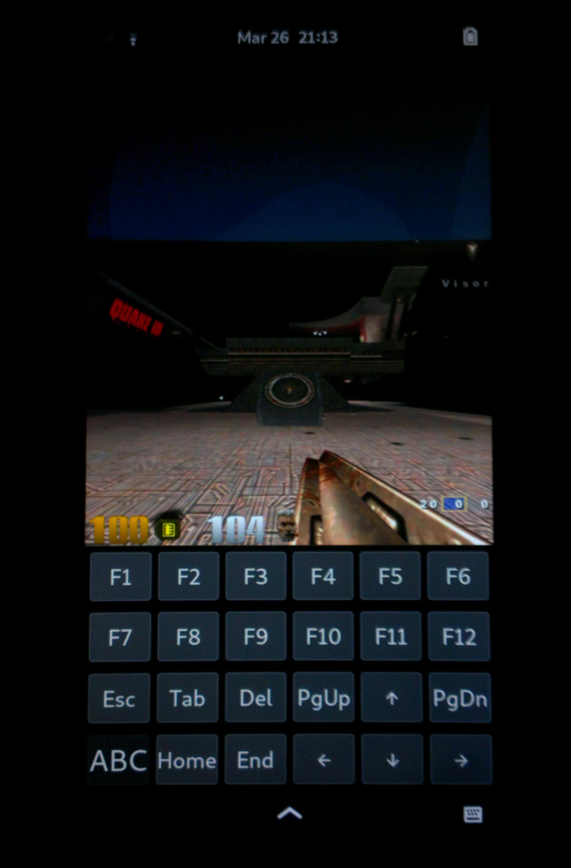

Games can be launched from command line but emulationstation crashes on load (x connection broken error) and the virtual keyboard map is pretty random. Anyway, here's a blurrycam video showing it in action.
.jpg   quake3a.jpg (Size: 183.37 KB / Downloads: 970)

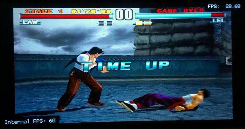

Just playing with the various audio settings to try to reduce stutter - selecting the tinyalsa audio driver seems to help. I suspect someone more familiar with the retroarch settings could get it running pretty smooth.
.jpg   tekken_pcsx.jpg (Size: 65.01 KB / Downloads: 820)

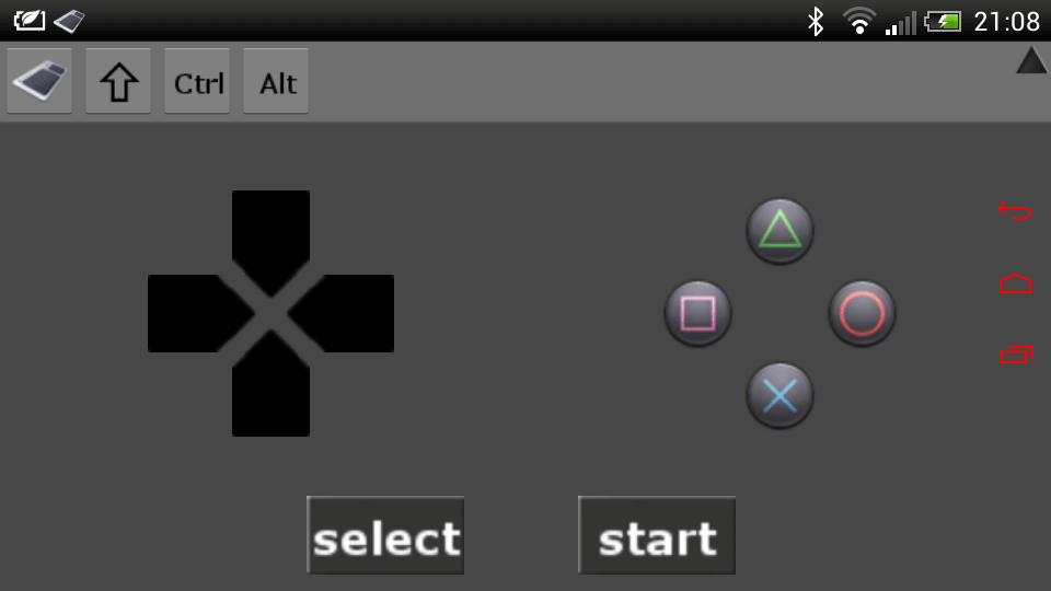

As an alternative, I managed to get bluputdroid working on another phone to basically emulate a bluetooth keyboard/joypad - and yes, it connects to the pinephone and inputs are picked up by retroarch/games. Not a real substitute for hardware but it works! Big Grin
.jpg   retroarch_pinephone.jpg (Size: 73.77 KB / Downloads: 869)
.png   bluputdroid.png (Size: 21.33 KB / Downloads: 785)
