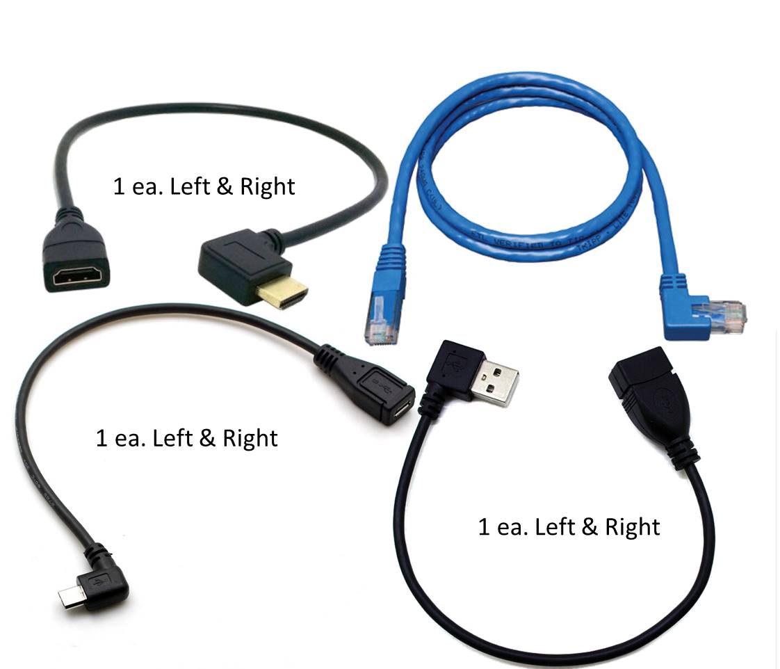

Well, because my new Samsung Evo+ micro SD card solved my other issue, I'm moving forward with this project.  I've ordered the following close-quarters cables (one isn't due in until June 1st).  Then I'll see if this case will work.  I have another, slightly larger--but not as nice looking--router case that I can hack if necessary.
Well, I got my specialty cables in and there just isn't enough room for them in this small router case.  I guess I'll hang onto the case for a Pi project in the future.  Oh well.
