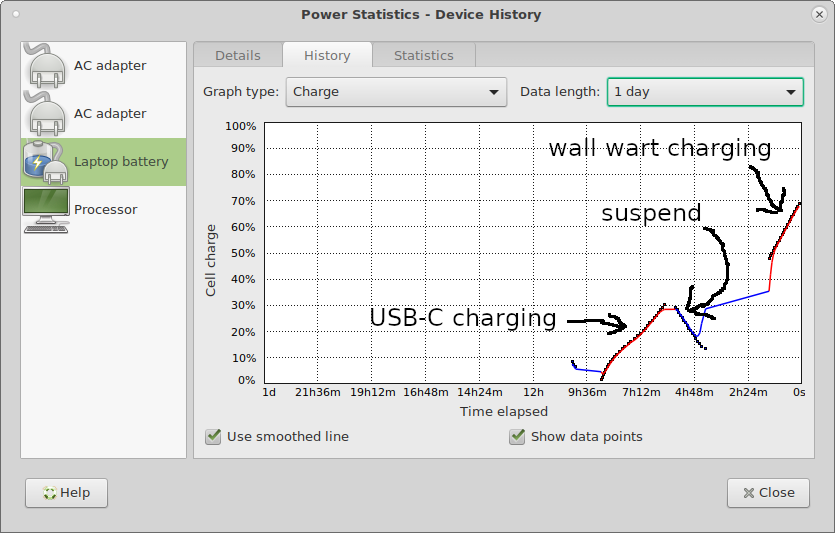

I measured the power usage over a day using the Mate power daemon. This is what it plotted.
.png   pbpro_power.png (Size: 67.21 KB / Downloads: 917)
It seems that charging via USB-C is almost as efficient as using an actual charger. The suspend one is weirder: it uses energy as much as a charger can put in the battery. I entered suspend by clicking on the power button and then selecting suspend on the pop up menu. Obviously something is not being properly powered down. This is with the default Debian image.

Hmm... ~20% in 1 hour. I haven't dealt with laptops for quite some time. Does it look a bit slow?
It looks like 3A DC is not enough to power a running machine. My one, even though it's powered by the DC adapter, still drains the battery pretty fast (under heavy load, I must admit). Wonder if having a 4A adapter would help?
Heavily loaded, PBP drains about 3.5A from the battery. No wonder it is discharging even with the DC adapter in.
(11-07-2019, 03:52 PM)jpakkane Wrote: I entered suspend by clicking on the power button and then selecting suspend on the pop up menu. Obviously something is not being properly powered down. This is with the default Debian image.
This is a known issue. Here is part of the discussion:
