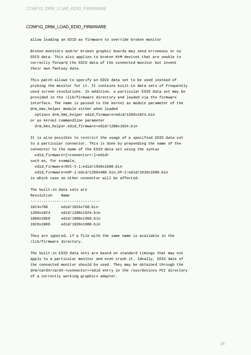

OK, I got 1024x768, I'm unstuck.
Check the files in /lib/firmware/edid, I had to copy a set from Armbian.
Edit /boot/efi/extlinux and add your mode to the append line like:
drm_kms_helper.edid_firmware=edid/1024x768.bin video-HDMI-A-1:1024X768
Then update initramfs with update-initramfs -u and reboot.
You should have an edid file to match the video mode you want, and even then not all modes work.
Thanks to mth on #Rock64. If you don't want to get on IRC you can search the logs at http://irc.pine64.uk/
Check dmesg | grep edid if you're having problems..
For completeness, this is from docs-master/Develop reference documents/DISPLAY/rockchip_drm_integration_helper-zh.pdf page 26

When you replace the kernel (or initrd.img) you might have to do "update-initramfs -u", I'm not sure how that works. I didn't backtrack on anything, just picked a mode with drm_kms_helper. Did it before I found the PDF on how to do it, I think I got it from somebody on IRC.
(07-28-2018, 05:45 AM)ab1jx Wrote:
(07-28-2018, 04:53 AM)Averell Wrote: sledgehammerish, OK, but it worked. Replacing only the extlinux.conf file did not work. Replacing the dtb file did not work. replacing initrd.img file alone breaks the system. The problem was in the 0.5 kernel, and the question was if was possible to replace by the 0.6 kernel without breaking everything. I expected it would, but this didn't and the system is still running well.
I just did it again a year or so later.  I grabbed an EDID file using tvservice on a Raspberry Pi and put it in /lib/firmware/edid.  I didn't do the update-initramfs.  This time I wanted to get 1920x1080 which the Pi defaulted to anyway.  I'm not sure if it matters but I did this using the monitor I wanted to use, which worked on the Pi but not the Rock64 (until I made the EDID file).  I did have to power it off and back on, not just type reboot, before it worked.
So I have /lib/firmware/edid/piedid2.bin and in /boot/extlinux/extlnux.conf I have  drm_kms_helper.edid_firmware=edid/piedid2.bin  I did have to make the edid directory in /lib/firmware.
