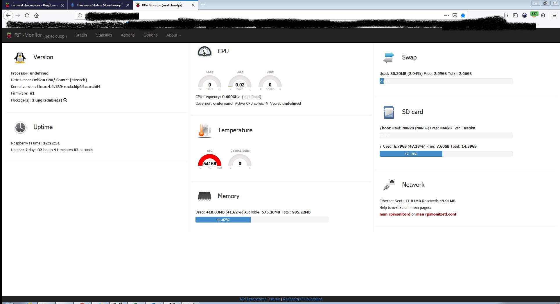

[attachment=1374][attachment=1374]
(03-20-2018, 12:48 PM)Leapo Wrote: Is it possible to measure hardware status (core temperature, core voltage, core clock, memory voltage, memory clock, etc.) on the Rock64 under Linux? So far, I've managed to read core temperature and clockspeed, but that's about it.
I know vcgencmd works on the Raspberry Pi, and was ported to the Pine64, but I haven't seen anything similar for the Rock64.
Is this sufficient for your needs?
https://forum.pine64.org/showthread.php?tid=4462
.jpg   monitor.JPG (Size: 215.73 KB / Downloads: 711)
