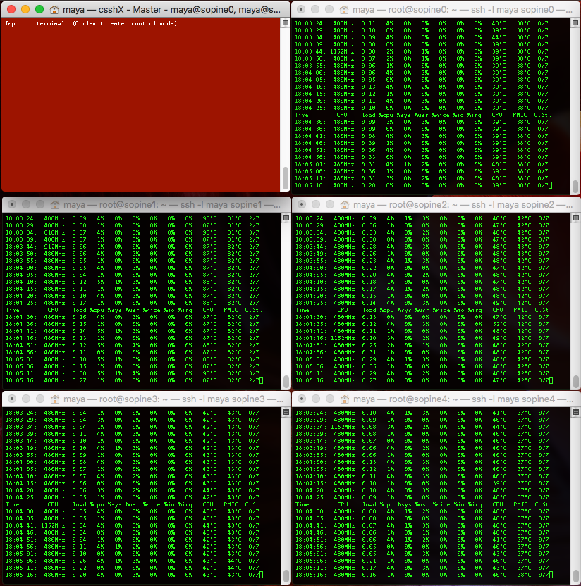

They're in order from right to left 0 through 4, and sopine1 is running stupidly hot despite not doing anything as confirmed by the terminal screen cap. The outside modules are the coolest, while 2 and 3 are taking some extra heat.
