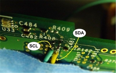

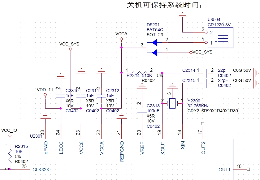

Attached is the RTC mod circuit for ROCK64. However, ROCK64 don't support battery charging and no such circuit available.

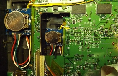

Basically then all I need to do is solder on a battery to the Rock64 board.
I have done similar here with my tabletop touchscreens.
or maybe just purchase a
PiFace RTC which I have done for my RPi's over the years such that no soldering is needed.

The ROCK64 board with RTC battery connector is not abandon. Check out the FOSDEM PINE64 table stand photo and you may able to spot this board.
This is just a minor change and we will revise board revision during production run sometimes on Q2 2018 timeframe.
