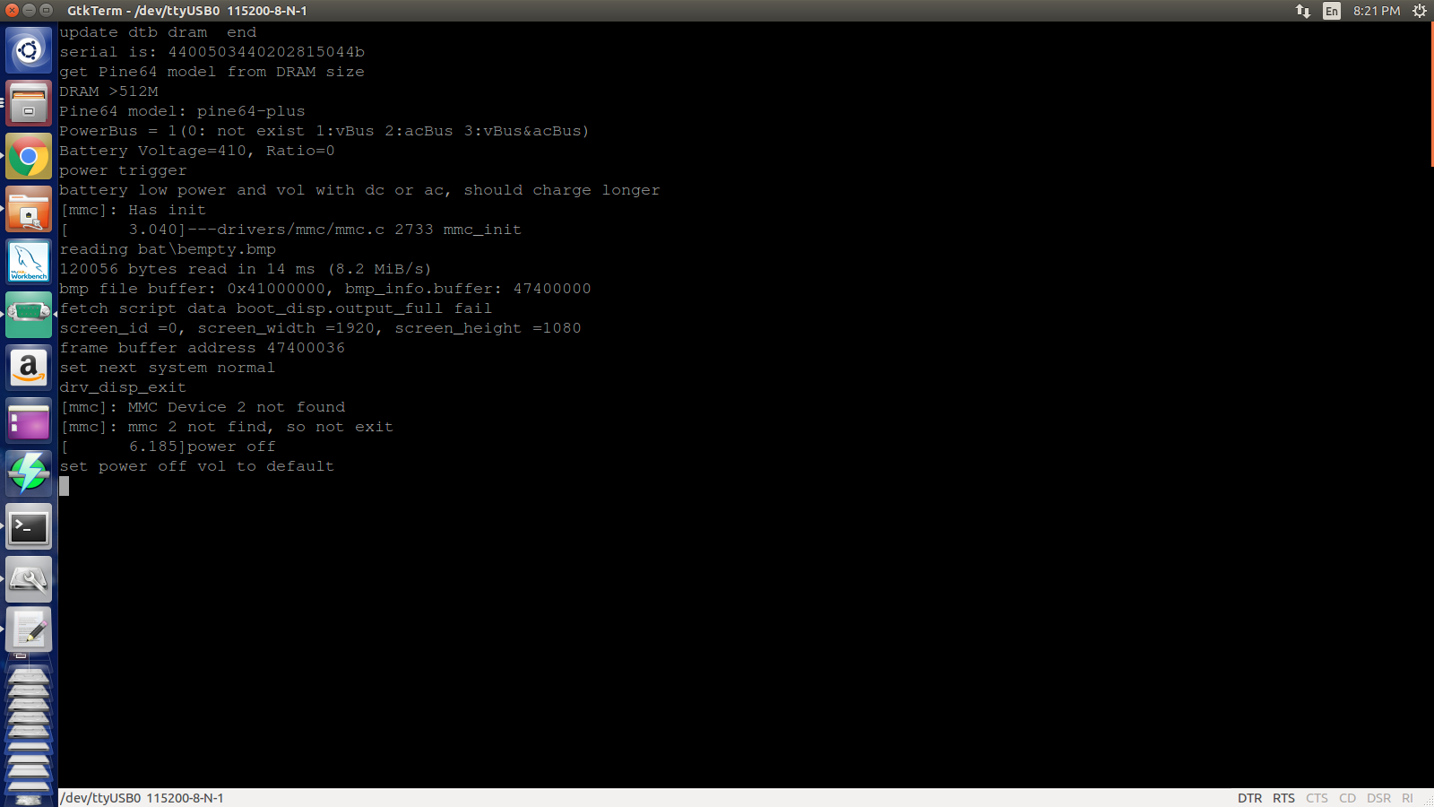

I am trying to boot 3.10.104-2-pine64-longsleep ubuntu 16.04 image in pine 64, but it is not booting .It structs in U-boot and not booting further. Need help on this. I have attached the picture of where its structs in u-boot. Kindly go through the picture and give me suggestion to solve this issue.
